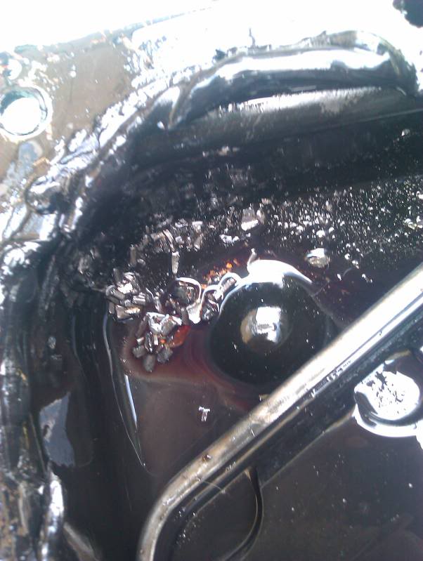

pops Jun 11, 2011 05:32 AM
well its bad news i think. got the sump and filter off now and i have loads of small bits of metal in the sump. im thinking that i need a new box :eek:
pops Jun 11, 2011 05:38 AM
1 Attachment(s)
Attachment 1827
TNtech Jun 11, 2011 03:49 PM
That's a unit!
