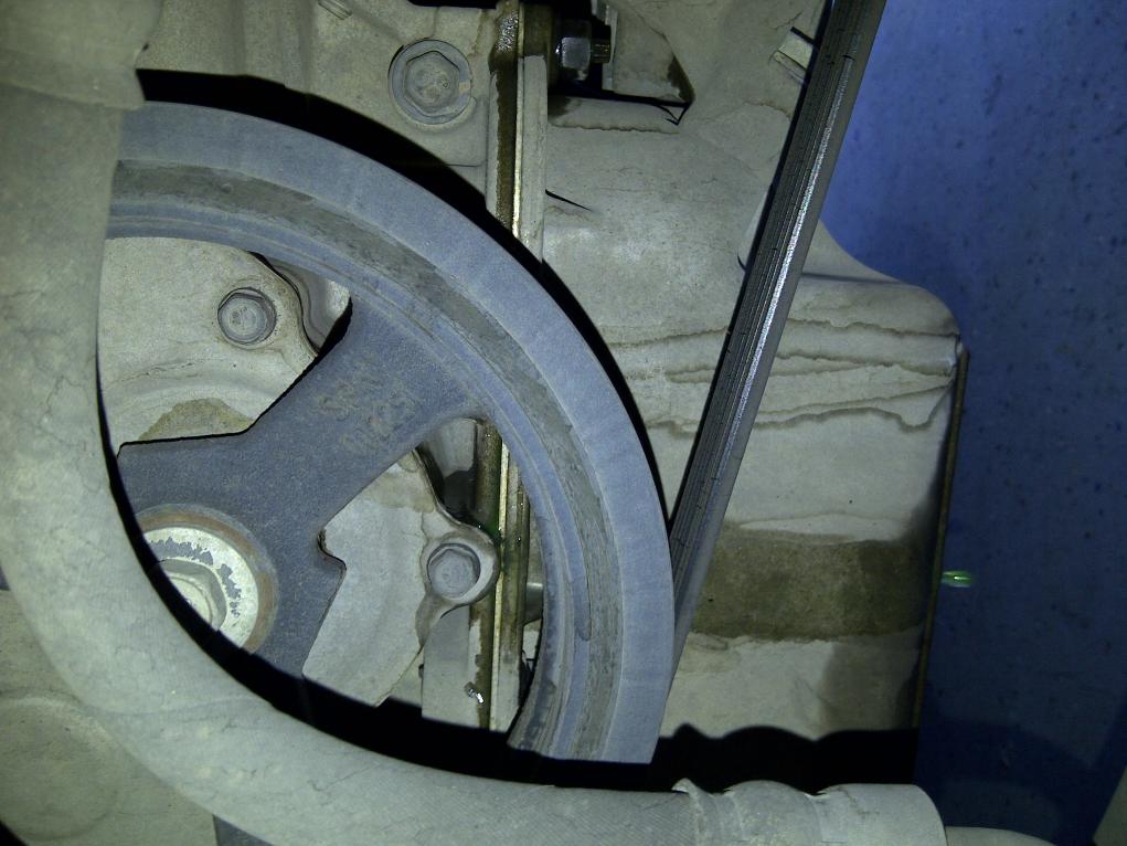

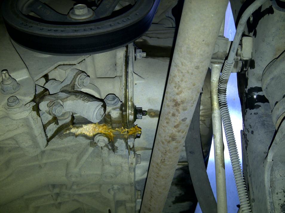

Hi all. Well, the damn radiator hose popped off and overheated my engine. I think to the point where gasket gave out and the coolant leaks. I took some photos so hopefully someone can tell me the target area to trouble shoot.

Your water pump is behind that cover. Try not to drive it anymore. You'll need a timing belt too while they're in there.
