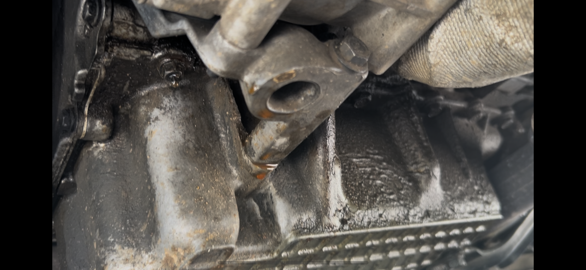

I noticed this morning the coolant I put into the reservoir leaks out at that location in the pic. Nothing more just that amount.

So I just jacked the car up and I can see the weep hole and the leaking is actually coming from the bolt on the housing next to the weep hole. Maybe the ring is bad? I’m going to change the housing and ring and thermostat out soon. Go from there. If it’s the hoses maybe I should change them as well to be safe. Eliminate all possibilities first. Then see if it clears up.

Does running the car count as a pressure test? Only leaks when it’s running. Leak is coming from the thermostat housing. I could see the weep hole and it didn’t look like it was leaking. The bolt next to it was running fluids though.

Main reason for suggesting the static pressure test is being able to poke around and not be concerned about moving belts and hot hoses.
Note the brass inserts in the housing. The gasket does the sealing so no amount of over-tightening will seal a leak.
Suggest also replacing the gasket along with the thermostat housing. Get a quality replacement for both, suggest 'rockauto.com'. Be wary of amazon auto parts as there are quite a few counterfeits on there. Ebay not as bad but caution is recommended. Parts can be purchased locally at an auto parts store but rockauto is cheaper even with shipping costs.
