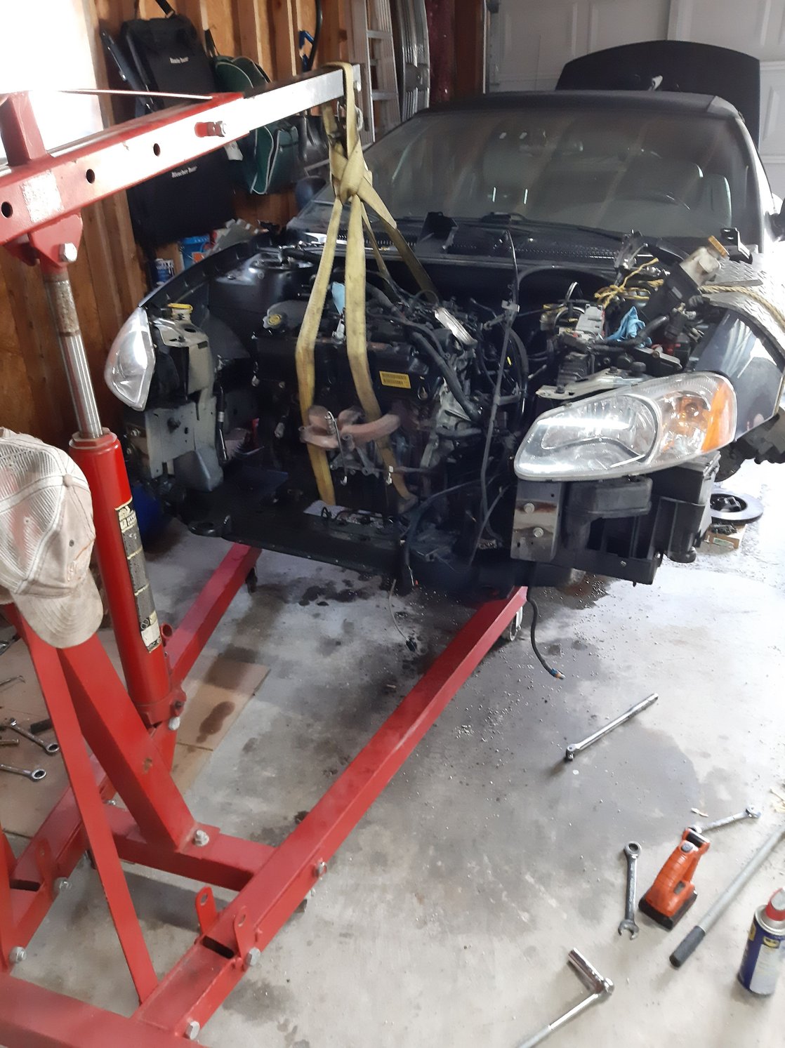

Old Jun 20, 2020 | 08:09 AM
Larry Martin's Avatar
Joined: Jun 2020
Posts: 9
Default Engine. Removal 2002 2.7
Originally Posted by keithm
I’ve got an 04 in getting ready to remove to put another in. Was looking at the service manual(Haynes) which is saying the convertible has to come out the bottom. Is that true. I thought I had seen somewhere you could remove the grill and radiator support and come out the front
you can do it that way it is a lot of work and a very tight fit advise after evacuating compressor you remove it, and the alternator, serpentine belt and tensioner. There is a lot more to do to get things out of the way but Canberra done
