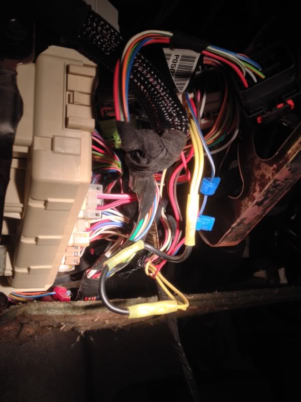

So today I ran through some other tests an then moved to the BCM "Body Control Module" So I dropped the steering column lower cover and after poking around for just a few I uncovered something of interest. O_o
Shortly after the discovery the 747's started showing up and lift me away so it will be Tuesday after work before I get a chance to see if this is the cause of my sons woe's.

Also just confirmed BCM is working.
