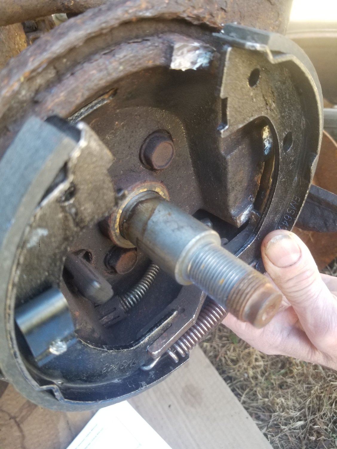

Old Mar 21, 2021 | 02:06 PM
Zach Wilson's Avatar
Joined: Dec 2020
Posts: 10
Default pics
im working on it right now. gonna post some pics and vids n see if anyone sees something wrong. i have a hard time keeping the L of the actuator lever behind that block (ill show in video) it seems its supposed to be there, one picture in the manual shows it there, and if its not behind it, its pinned between it and the back of the shoe. when i manage to get it behind there its only by the tip of the corner and it slips out if anything moves. also the entire situation is SO TIGHT i can't imagine how it could ever move and function properly
nvm it wont let me upload the vids
