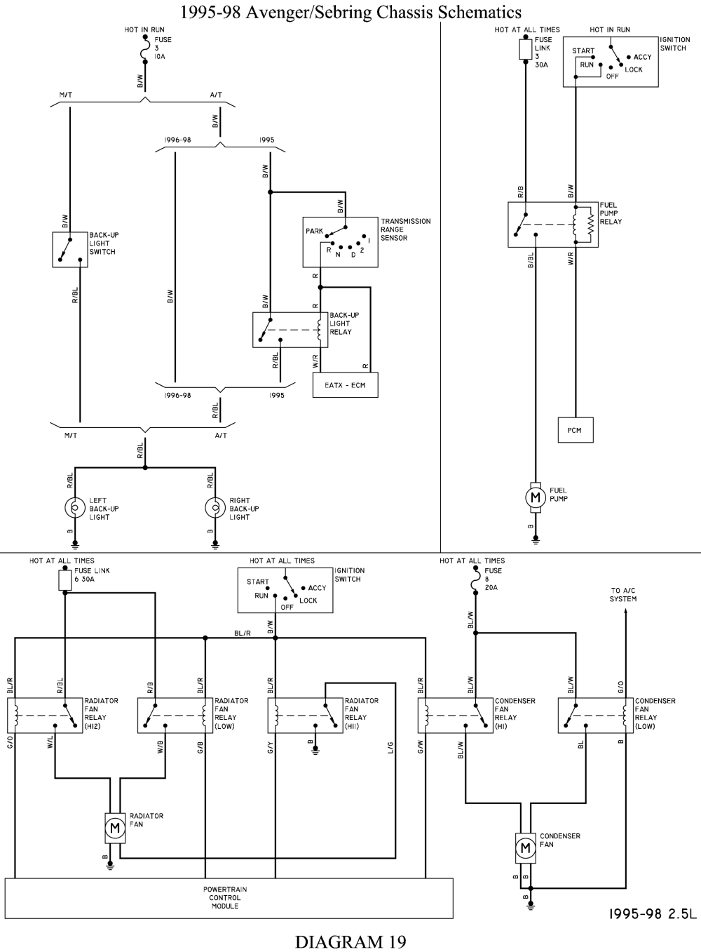

I have been targeting the TRS as the culprit but according to this schematic, it appears that the 97 model does not have a TRS. Can someone verify this for me please?
Attached Thumbnails 97 Sebring sometimes wont crank over-0900c15280089a58.gif

Welcome to the Forum, I have a 98 Avenger Coupe,2.5L motor. Never had a problem from it, perhaps you could describe more of the actual symptoms of your ride and what you have found that does get it to start. Ijust have the Haynes book at hand for it and wife has the car at work right now. But one thing I have learned is the various main ground wire connection (battery to motor and body) are important for having good CLEAN connections.
Can you confirm what motor yours is also please? As the older sebring coupe and Avenger are the same.
