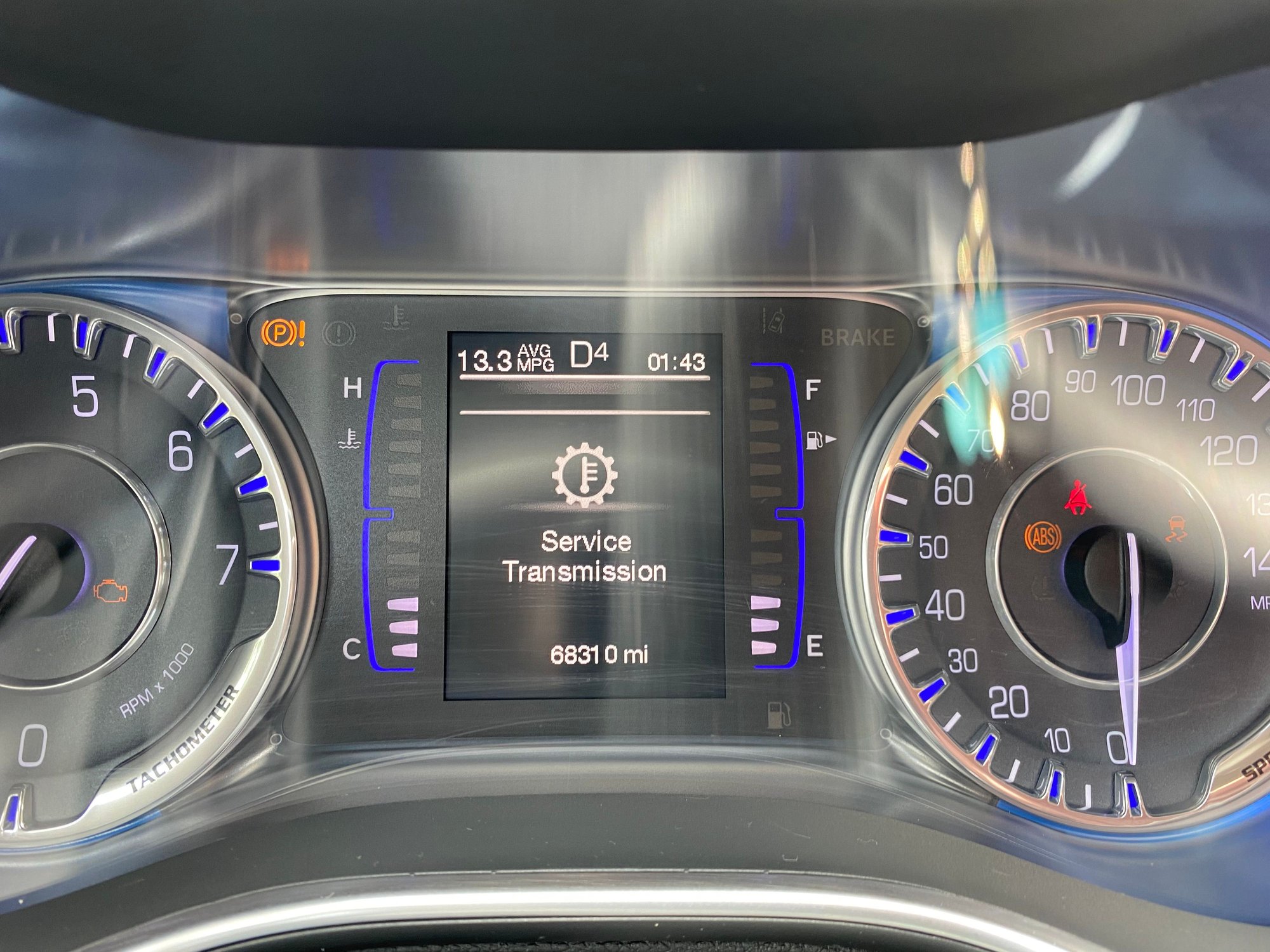

Hello,
Our 2015 Chrysler 200 5” radio messed up and was causing battery draining issues with the vehicle. We ended up replacing and upgrading to an R3 8.4 radio. Its been working good and last week we finally did the proxi alignment due to flashing mileage and communication loss codes. Once we did the proxi alignment everything cleared and car was 100 percent free of codes. Just recently the car came up with codes and messages saying to service transmission, service park brake, and abs traction control. Car steering wheel is hard and car drives sluggish. The car does shift but it almost seems like it’s not using all shifts. Very odd. I’m here looking for advice. Any idea what could be causing the issue???

U1412 & U1409 are the two codes that showed up. Last night I tried disconnecting the abs connector and reconnecting. Also I washed behind the wheel area just in case the speed sensor was dirty. The warning lights came off on the vehicle shortly after and car was driving perfect. Now this morning, warning lights are all showing up again.

U1409 left front wheel speed sensor error
