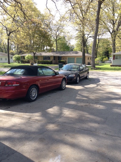

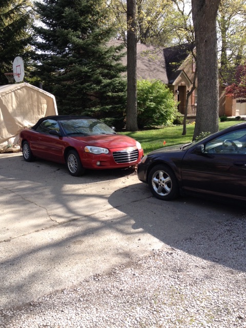

I ended up with a 2004 Sebring Convertible with 7,318 miles (!!) on the clock. And a locked up motor. I got it from (ready for this?) My wife's ex-husband's step-dad after the ex-husband's mom passed. Just before the step-dad passed, I gave him $500 for it.
Yes, convoluted, but here it sits in my driveway.
I basically have a brand new 2004 Sebring.
I've been looking for an engine. Yep, 2.7. I know that a rebuilt long block would be the 'best' way to go. However, not in my limited budget. It is the later engine, so even a usedengine from the salvage yards, they wanted a minimum of $800.

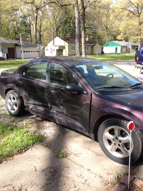

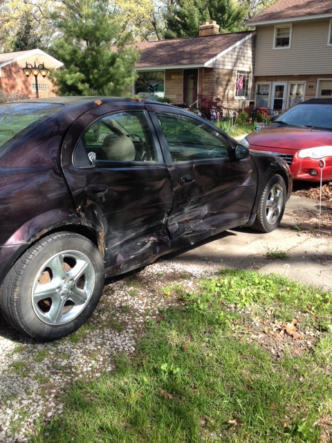

I finally found the ad on CL that I've been looking for, for almost 2 years. "2004 Stratus 4dr 2.7 V6 150,000mi runs great, new tires, cold AC, always used synthetic oil, religious maintenance, Had been T-Boned, $400"!!!!!!! And it's the correct engine!!!
So, I'm now getting together parts to freshen the engine and then do the swap. I plan on changing the timing chain, tensioners, etc., water pump, oil pan gasket,etc.
I wasn't planning on changing head gaskets unless there is a pressing reason to. Engine runs great at the moment.
Remember my limited budget.(I spent 2 months worth of my auto repair budget to grab the donor car for $400.)
I thought that I'd replace everything that might be leaking or need replacing on a 2.7 engine with 150k on it. Head gaskets will come at a later time, but are doable with the engine in the car (or aren't they?).
