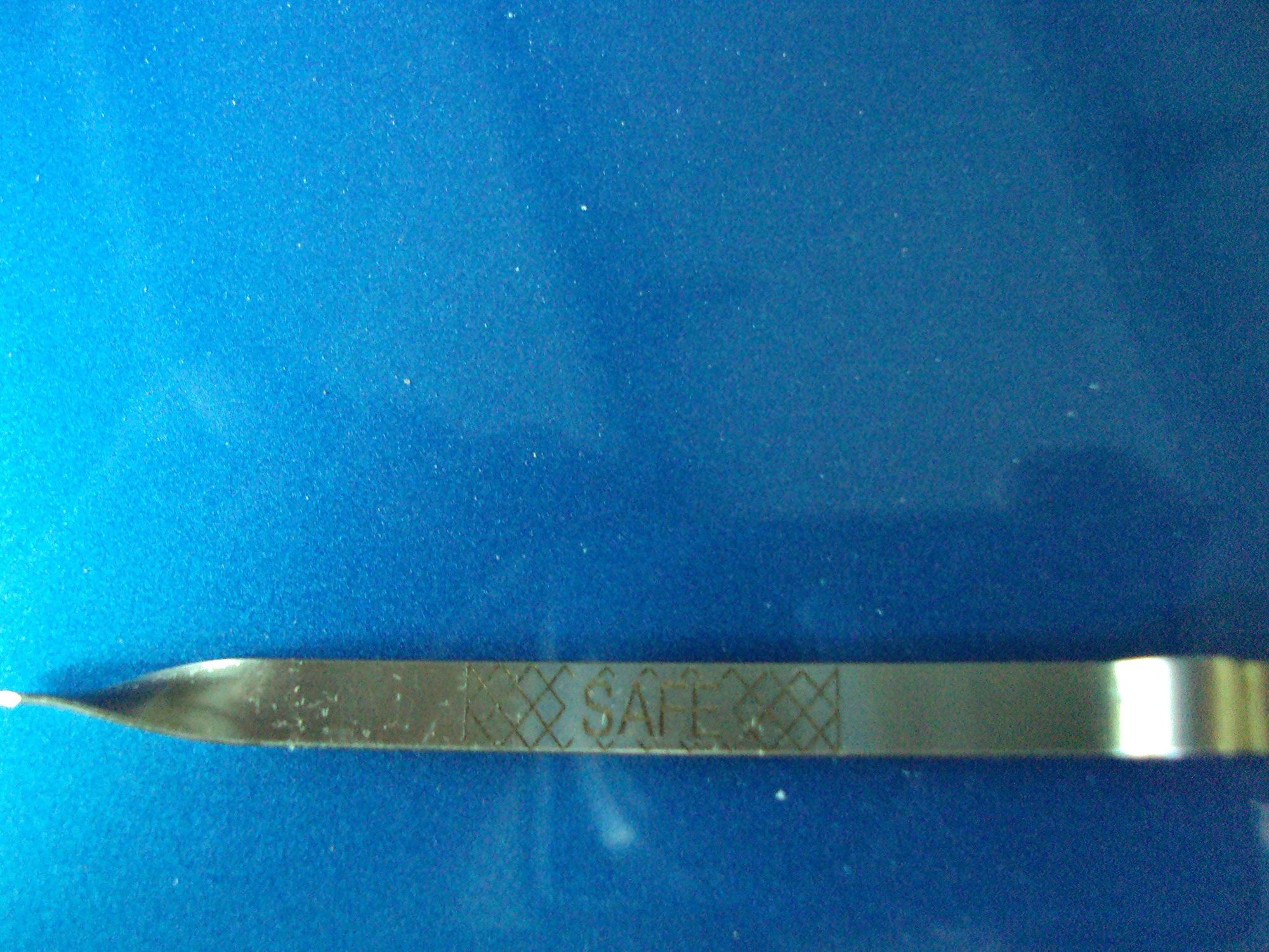

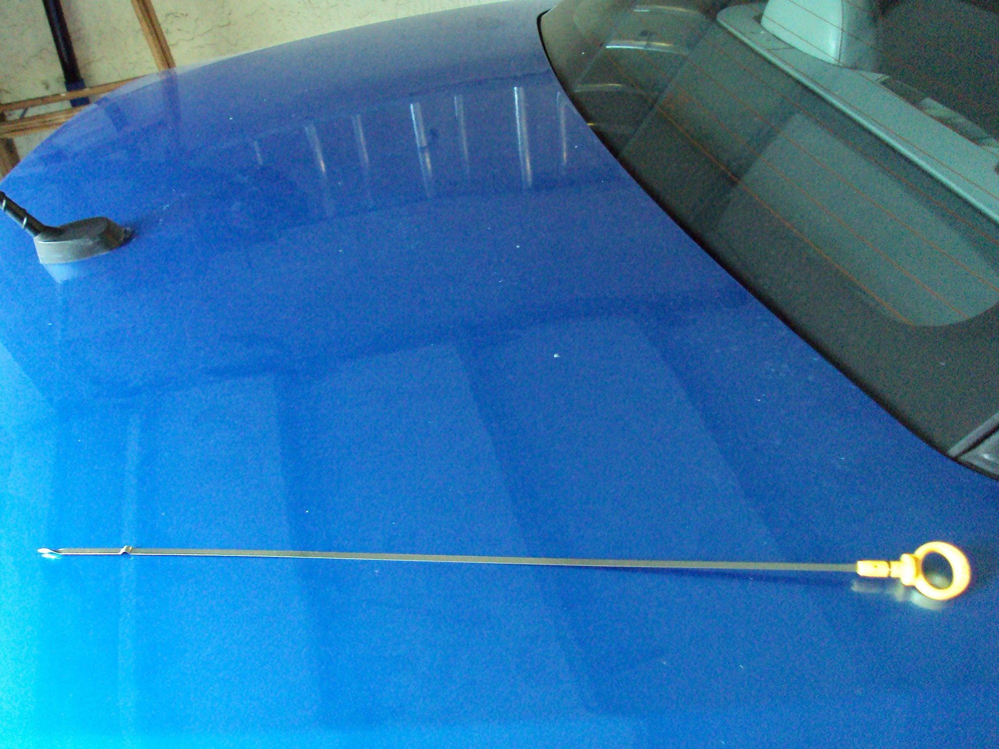

We have a 2008 Sebring with a 3.5L. The owners' manual indicates 5.5 quarts of oil to fill the pan and filter. When I fill to 5.5 quarts, the dipstick indicates low, in the lower end of the "safe" range on the dipstick. My mechanic says to fill to the normal full line regardless of what the manual says. 6 quarts will reach to a little below the top of the "safe" range. Searching online, I cannot find a length for this dipstick I can trust (it depends on where you measure from). The photos below show my dipstick. The length of the metal portion is 21 1/4". The length of the metal portion and the lower end of the yellow portion which seats in the tube is 22 1/4". Does anyone know if this is the correct dipstick, or has anyone run into this issue. Thanks in advance.

Do a search on the OEM part number listed in the description and search for 'mopar 4892121AA' Go to one of the mopar parts sites and verify the vehicle fitment. Shows 4892121AA fits 2008 Sebring with 3.5l engine
Side note, the 3.5l in the '06 charger takes 6.5 quarts

There should be a part number on the dipstick; may not be a mopar number but there should be a number.
If there is any question, order a new one if only for peace of mind.
