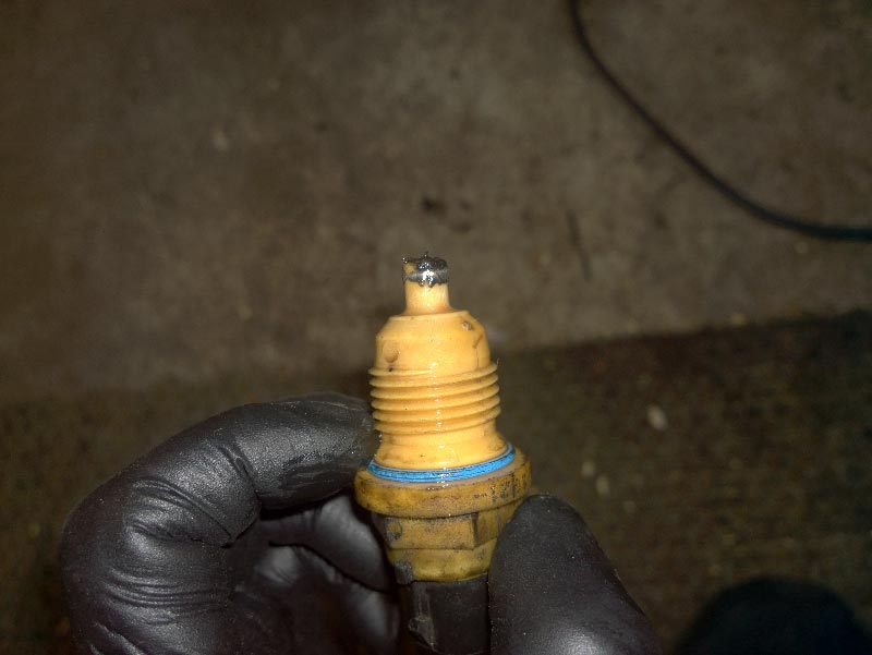

Changed speed sensors, filter as you can see its original chrysler, fluid was brown.
Magnet had some metal that was soft to touch and very few tiny pieces of metal size of sand that i feel.
Also output speed sensor had same stuff as magnet on it because it has magnet inside.
I put Wix filter and rubber gasket because i am going to run it and then swap filter again because new transmission fluid will wash all the dirt off and filter will grab it.
Whats that black stuff on the filter, why metal pieces on magnet and vss got soft?
Attached Thumbnails Sebring 2001 Automatic Transmission Problems-filter.jpg   Sebring 2001 Automatic Transmission Problems-magnet.jpg   Sebring 2001 Automatic Transmission Problems-oss.jpg
Old Mar 30, 2017 | 10:20 AM
The magnet is there to catch all those little bits of metal that would otherwise continue to circulate in the fluid and cause more wear. It's normal for the magnet to have a cluster of little metal grains after many years of operation.
When you drop the pan on the transmission only about 40% of the fluid drains out. You are right to expect that doing it again will result in getting more gunk out. If you cleaned off the magnet the first time, there shouldn't be much stuff on the magnet the second time.
Has the operation of the transmission improved?

I don't get it i did not reset computer however check engine went off but when i connected scanner it said not all self tests were completed (like after battery disconnected or computer reset) why would this happen?
Car drives fast speed shifting good, auto stick works, but this could been due to computer reset i guess i going to take it on a longer trip once i change coolant.
However there's still a noticeable shaking when switching driving modes, if i do fast from Park to Drive it does not feel going trough R and N and until D selected and there's sound like electric motor moving something in transmission.
I am going to change filter again and fluid but i want to give new ATF+4 fluid more time to clean transmission as it is a good detergent perhaps i change it after a 500 or so or if i start getting any troubles with transmission, i assume filter will catch any loose sludge.
