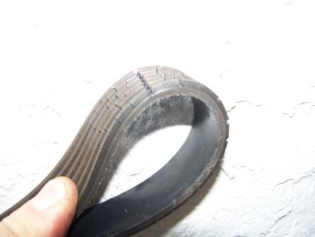

I found and loosened the lock bolt (left of the pulley) and got the belt off to find the one I got from the store was too long. After getting a closer fit I got the new belt on and all is fine The old belt had a lot of cracks and one point where they all lined up so I was glad to get it replaced. The power steering belt did not look too bad, so I thought I would wait a while for when I check to see if I needed to retension the large belt to maybe see about it . I also took a picture of the power steering, and will have to figure out what bolts need to be loosened to get that belt off.
