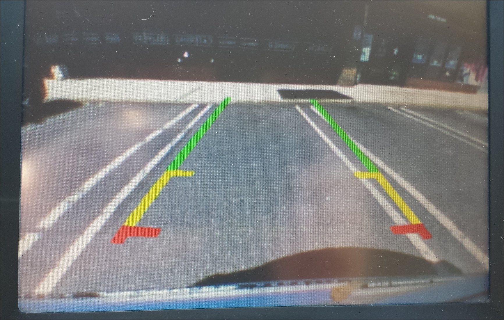

But I do want to post a picture showing this problem so other forum members can more accurately see what exactly the problem that I am seeing.
As you know, the grid lines are meant to show the where the sides of the car are in relation to the surroundings as we back up.
They should show us how far away we are from the curb.
They should also show us if the car is parallel to the curb and not angled into it.
Also, the distance between grid lines decreases the farther away the position on the grid line is and this is proper because things appear larger the closer they are to you.
But, the problem with the new camera's is that the grid lines are not drawn properly, making it impossible to use them to park our car in reverse.
Below is a perfect example of what I am talking about:
Above is a picture of my car backing into a parking space.
As we all know parking space lines are parallel to each other and are straight.
And you can see that the gridline on the left appears to be drawn properly because for the the entire length of the left grid line, the spacing between it and the parking space line is equal, as it should be - because this is showing that the car is at an angle that is parallel to the parking space, so if I backup in a straight line, by car will end up being parked straight inside the space and not angled in it.
However, as you can clearly see, the grid on the right is angle wrong, so it is not parallel to the parking space line, making it impossible to not only properly judge the distance my car is from the edge of the parking space, but I can't not figure out if my car is going in a straight path into the parking space.
The reason why this is a problem is that often we park on the street against a curb, so the left grid line is not useful because there is no line in the street to guide us. But the right grid line is VERY important so that we can both make sure our car is aligned parallel to the curb, and to also make sure the car is at a proper distance from the curb.
So hopefully this picture clearly demonstrates the problem I am having so I won't have to waste time going to the dealer just to confirm this, then having to go to the dealer again to have the camera replaced. Hopefully, a new camera that has been tested to not have this problem can be sent to my dealer, so I will only have to make one trip

A very good example JC300. I am not sure it is the same with my 16 and 19, but when backing up, the lines would show that my car is equal distance between those white parking lines, when actually the right side wheels would be on the white parking line, and there would be two feet from the left white parking line.My 2013 was dead on. Good luck in getting it fixed. My dealer did everything (I think), including a new camera.. I hope this customer care person helps. Please let us know if there is a fix.
