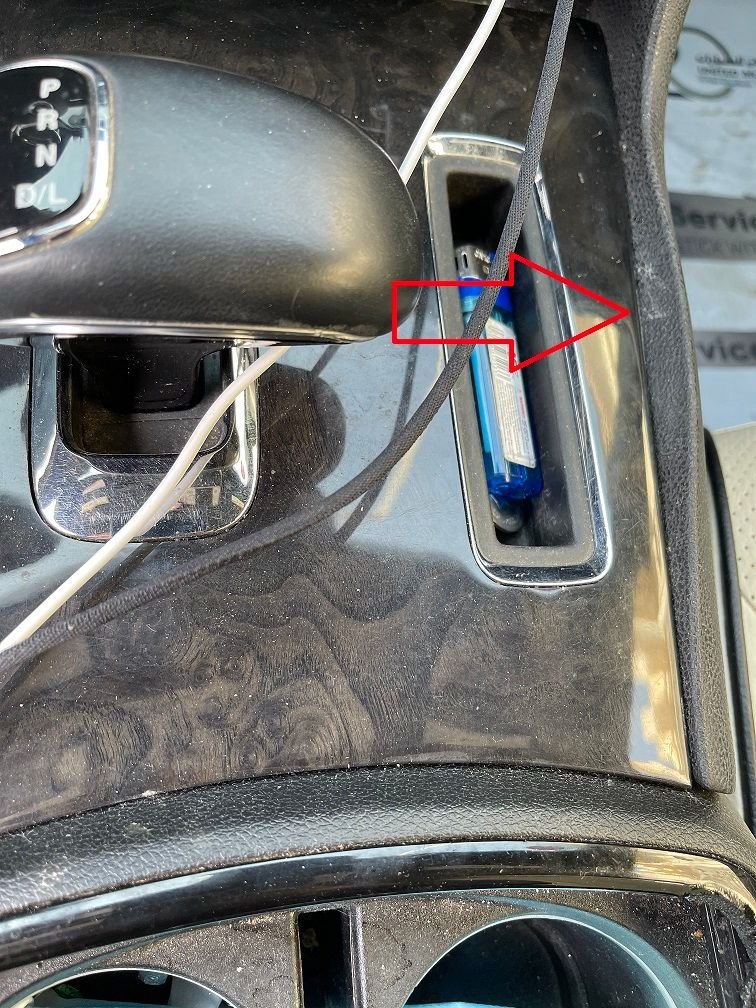

Hello
does anyone know how to remove the console panel on the passenger side?
I am attaching 2 pictures showing how this thing popped on the driver side and passenger side without any notice.
I think it can be glued back in if I figure out how to remove it.
Thanks
deformed panel
How to remove this panel?

Me thinks those are snapped in place but you'll need a new panel. The deforming won't go back and stay. I've not had that issue or what some show on the door panels deforming, but I park in a garage so they don't get much direct sunlight.

Does that mean I can just pry on it and pop that piece out?
I did try without prying too much on it or else break a clip or something.
I did search all over you tube, most talking about removing the shifter and entire console. for good measures, I did remove the shifter and black laminate cover
no screws there for the side panels!

This is what I have done. Not so sure how long it is going to last before deforming again!
I use two parts Power Epoxy, G plastic Clamp to hold it for an hour, and a piece of wood for even pressure and to avoid marks.
Pictures will illustrate the above
in the back injected molding separated from the plastic
Both sides were affected
Epoxy applied and pressed by G clamp
Finally installed back, not perfect but good enough for the time being
Hope the above helps, cheers
