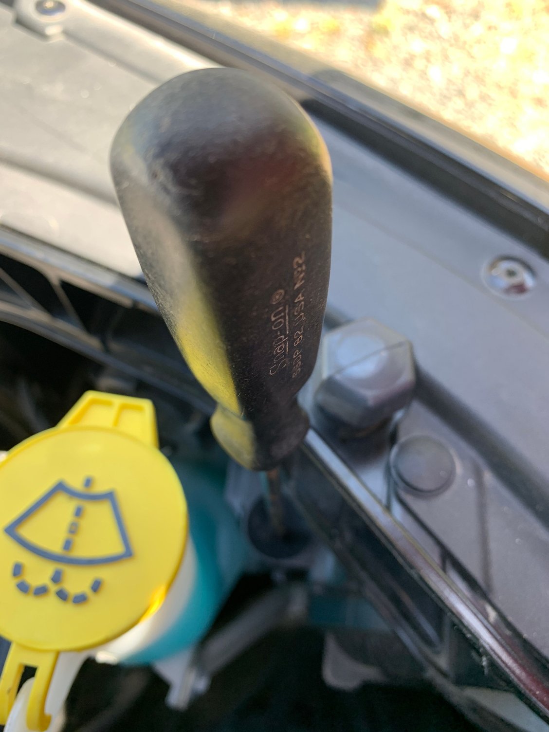

Halogen Projectors or HID projectors?
My 2020 has the standard Halogen projectors that can be adjusted vertically (no horizontal adjustment) with a long shank #2 phillips head driver or a small socket wrench/flat ratchet (8mm?). The screwdriver grommets can be seen from the top on either side. Be patient and make sure the driver is properly seated before turning. I used the screw driver after wasting $94 at the dealer on what I thought would be a warranty adjustment.
