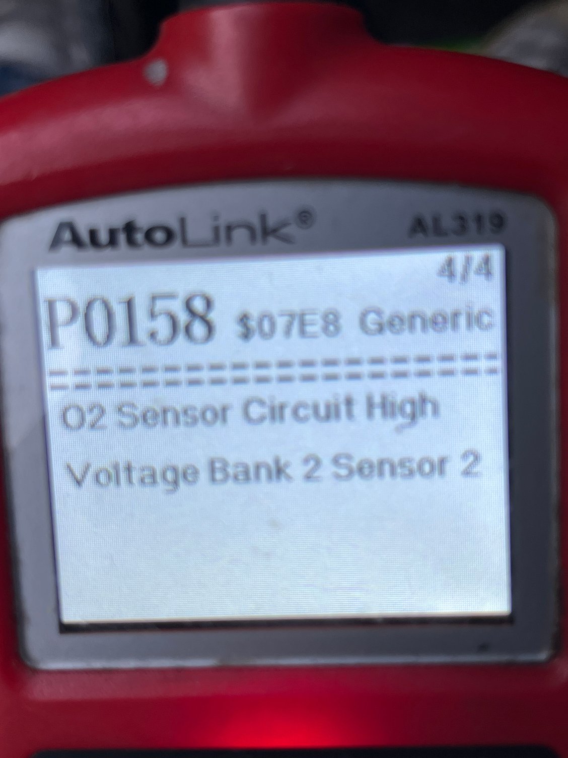

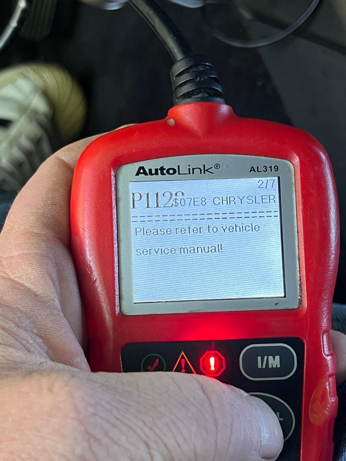

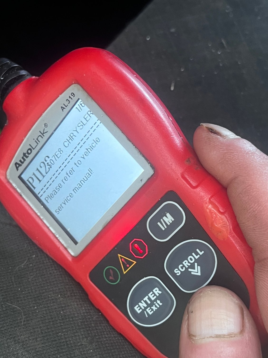

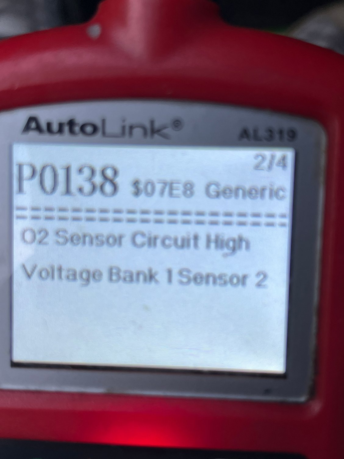

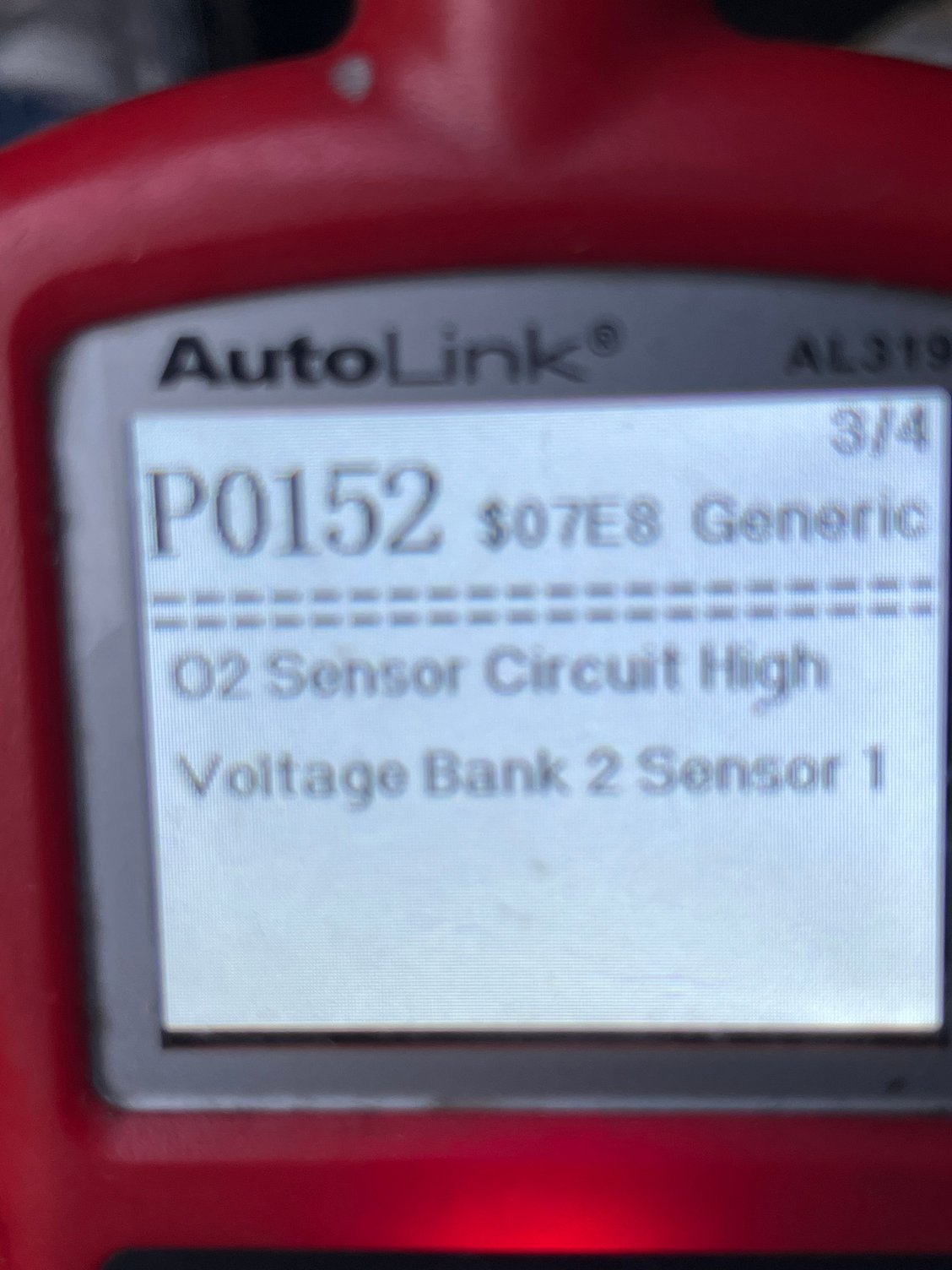

2007 Chrysler 300 2.7l Started when my transmission cooler line popped off got fluid everywhere and ruined a map sensor. I replaced map sensor car has ran like junk ever since OBD two said 1x o2 sensor was bad. I went ahead and I replaced all four of them and it now says that they’re are bad. Bank 1 sen 1 bank 1 sen 2 bank 2 sen 1 bank 2 Sen 2
bad on top of live data says Fuel system 1 and 2 Open Loop.
I have changed map sensor checked the throttle positioning sensor replaced the cam positioning sensor tried resetting codes. I’ve checked connections of wires and plugs. Make sure no shorts. I’m just chasing a ghost right now. Any ideas? Car idles rough like it’s missing poor acceleration, terrible gas mileage running rich if driven more than five minutes, you won’t be able to go. It starts spitting and sputtering until you pull over and it dies.

If those codes were prior to Oxygen sensor swap:
All four voltage high indicates open or poor GROUND. If I recall all do share a common ground. Looks good doesn’t cut it, grounds need to be disconnected and cleaned to be good.

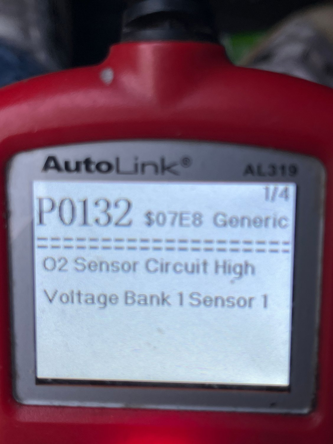

I kinda figured it was the quality of the o2 sensors. In the meantime I decided to check my plugs and test coils they were fine, I cleaned the spark plugs and put everything back and ran codes again and now two of the o2 sensor codes vanished now it says bank 1 sensor 1 bank 2 sensor 1 but now I have a new code P0132
I’ve had this happen before codes pop up then disappear when I haven’t done anything that should effect it. Any ideas ???
