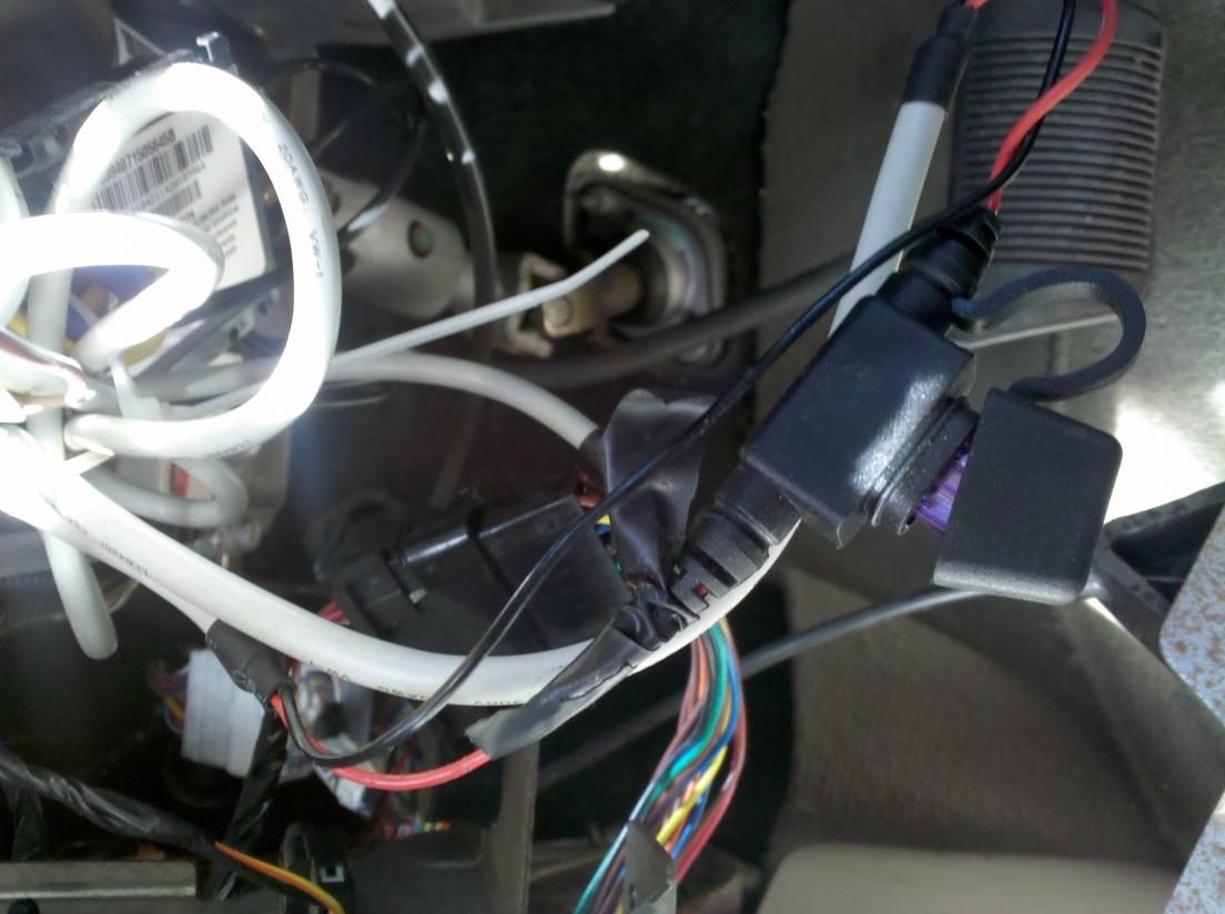

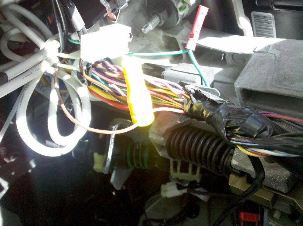

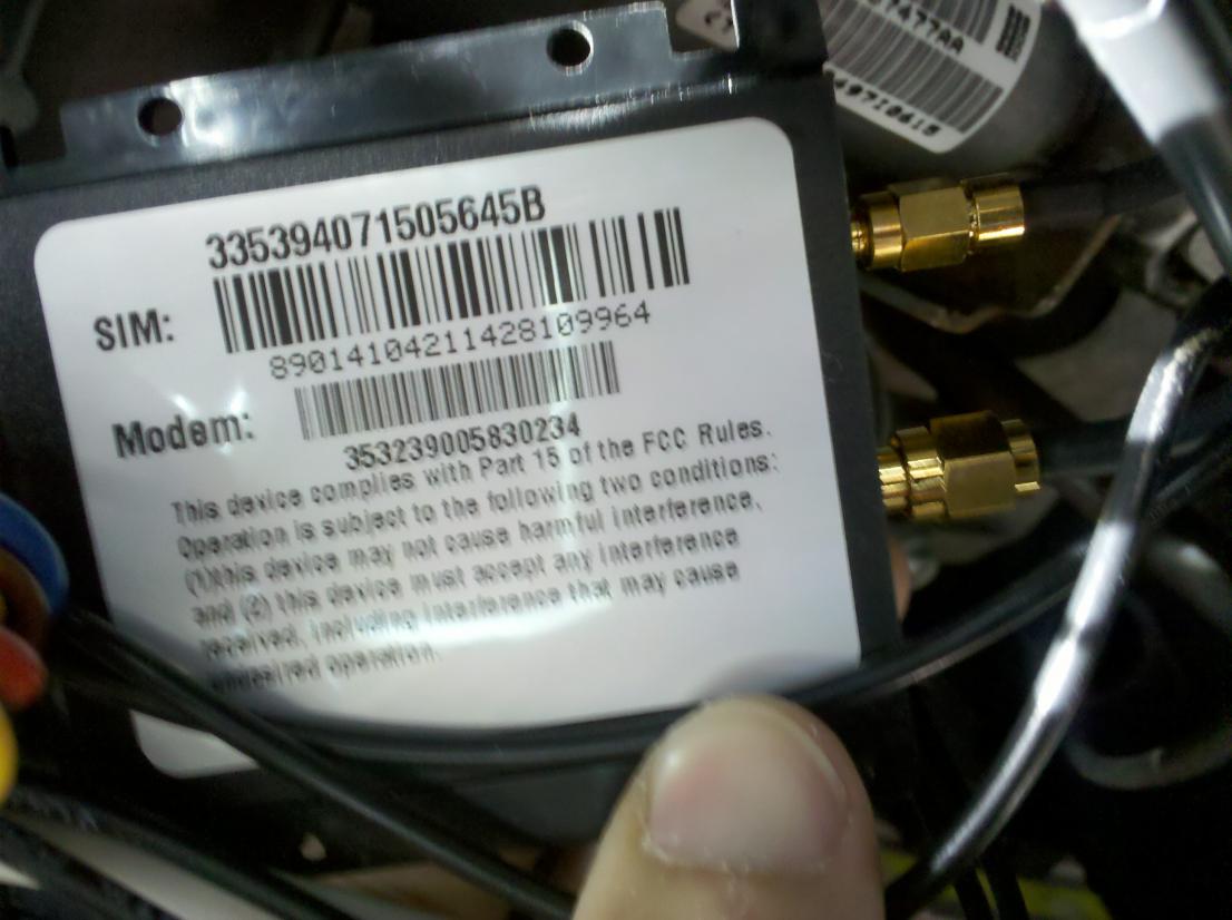

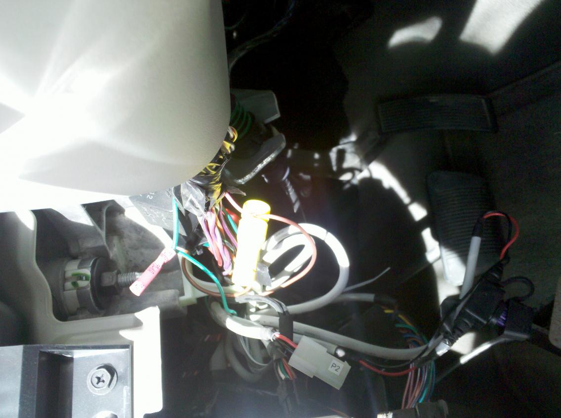

Ok - I couldn't take it anymore and I took every panel out. I think I found the culprit!!! When the car is running with the key in the OFF position, If I tug on any of the wires in the pictures - IT STOPS! Now, could someone tell me WTF is this? It seems that is interconnected into the OBD connector, it has 2 antennas etc. etc. Look at the pics!

Ok, ...My memory just punched me in the face. I saw this happen on a Dodge Nitro with an aftermarket DVD screen. There was an interference "CHOKE" in the power wire to the player that had burned up, and the Capacitance kept the vehicle running....
Im not sure what that is, but it certainly IS NOT a factory installed Item.....
Did you have a "U-Connect " system installed??? Or Possibly a "Tracker" installed by your finance company???? I would more likely think that is the case....Which would mean...YOU WANT THEM TO REIMBURSE YOUR INCONVIENIENCE AND DIAGNOSTIC TIME SPENT AT THE DEALERSHIP!!!!!!!
PIC #3...remove the little purple fuse from the holder , and see if that helps.....You may also expect a phone call from your bank, that they can no longer track your vehicle........... Or ...MAYBE....Hmmm...did you have a "Lo-Jack" installed????

Car paid for in CASH...Bought in 2008 from Budget VIP rental fleet...LoJack as as a gift from Budget?
