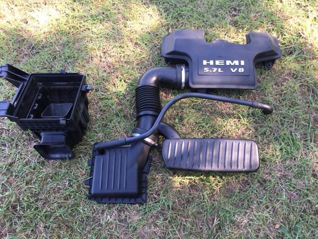

As promised, here are photos of my OEM intake system.
Air cleaner body. Two bolts holds it to fender.
Air cleaner top. Note the breather tube connecting to top. This runs to oil filler tube.
Air duct from air cleaner to intake box. Also has a second baffle which just sets on top of radiator. Not exactly sure what this does. Looks to me like it would add heat to the air.
Other end of breather tube that plugs in to oil filler tube.
Air intake box. Think it only had two bolts holding it on. The sensor plugged in to the bottom front of this box. Sorry, didn't get a picture of that.
Back side of air intake box which plugs in to the intake manifold.
All components laid out.
So there you have it. If your intake system resembles this one, I believe you can get the system for the 07-08 to work. Main things to look at here are the breather tube going from the air cleaner box to the oil filler tube (it comes with a new rubber hose which connects the oil filler tube to the new air tube), the sensor plugging in to the front of the intake box (new system comes with a rubber grommet which goes in a hole in the new tube and sensor simply plugs in to grommet) and of course, the connection on the front of the intake manifold. If it doesn't have the secondary baffle on top of the radiator I wouldn't worry about that. It's removed anyway and nothing goes back in it's place. One extra note here. The new system had a heat shield installed which attached to a bolt on the frame for the sway bar and two bolts on the radiator mount. I had to use new bolts for the radiator as the factory ones were not long enough and it did not come with replacements.

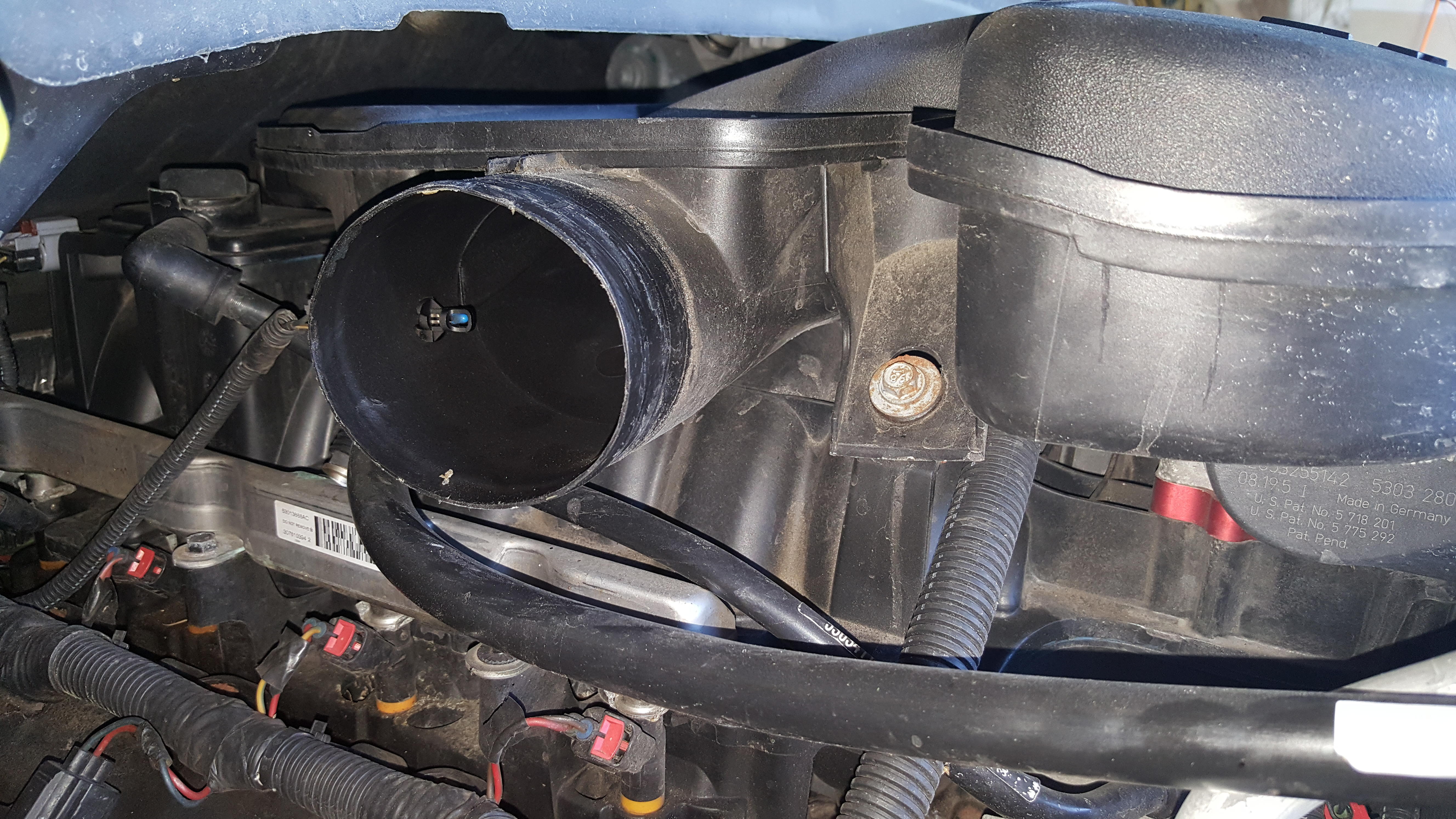

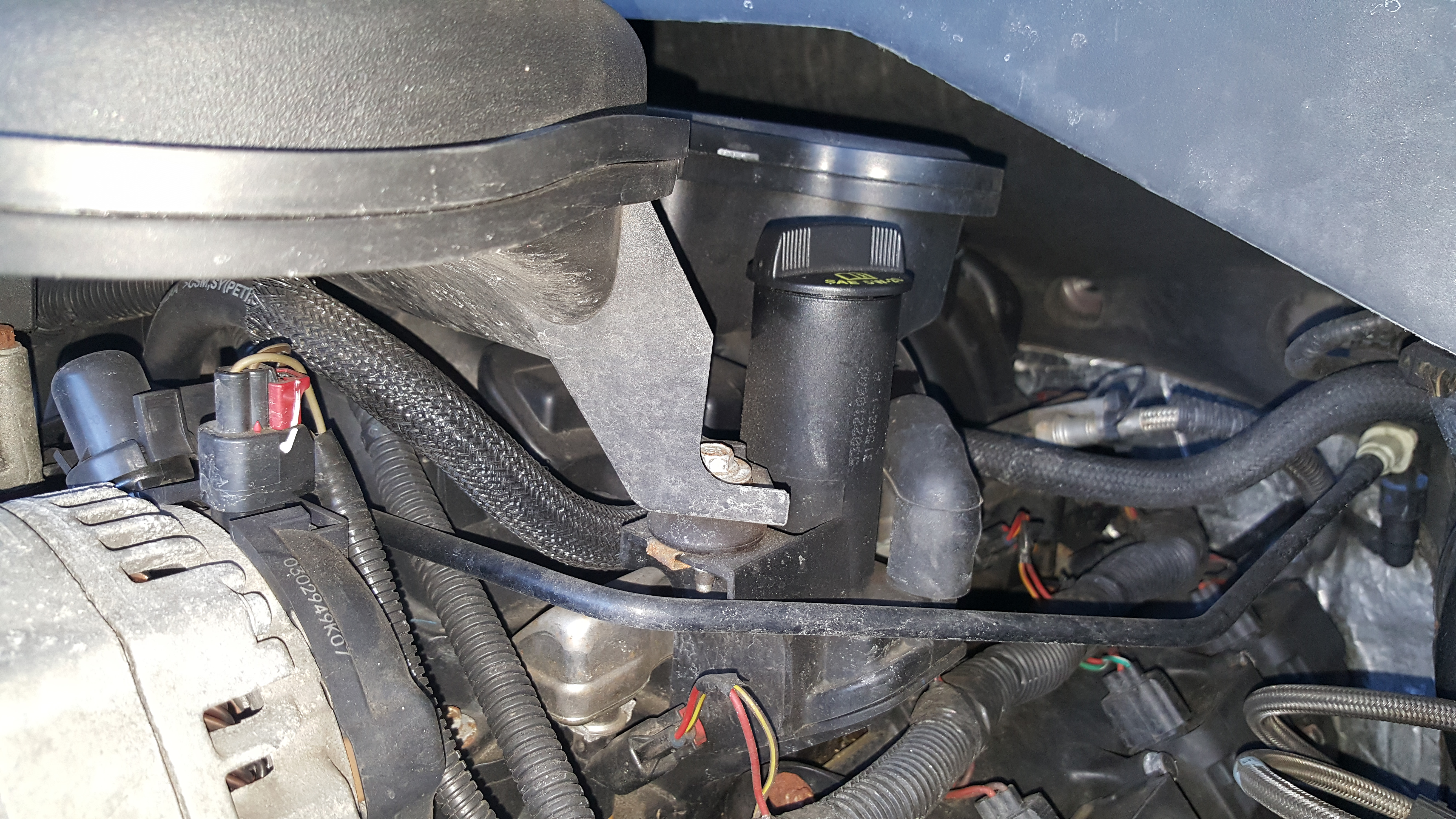

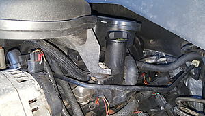

Thank you CC. I've uploaded several pictures and still waiting for my email to catch up so I can post a few more.

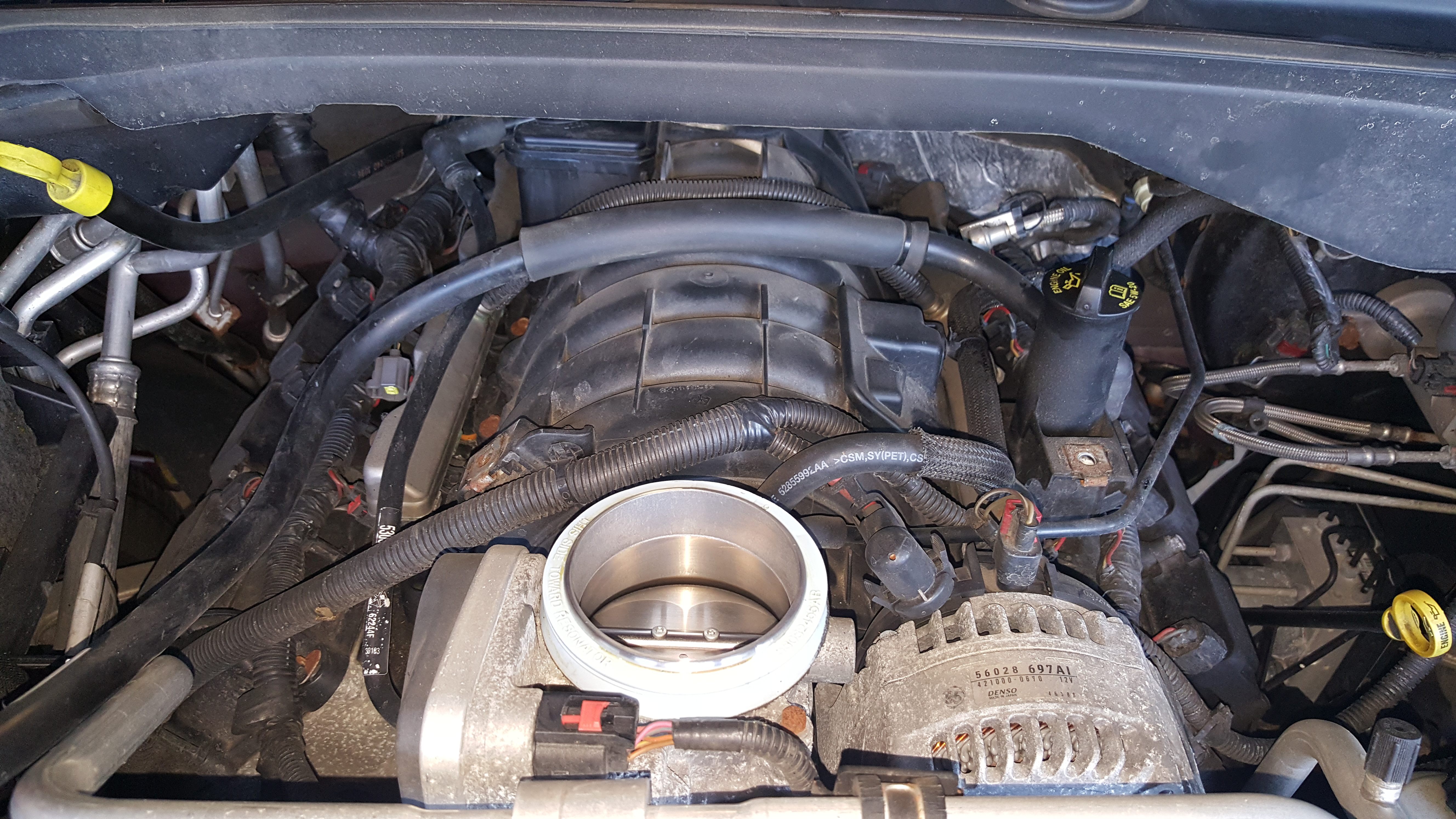

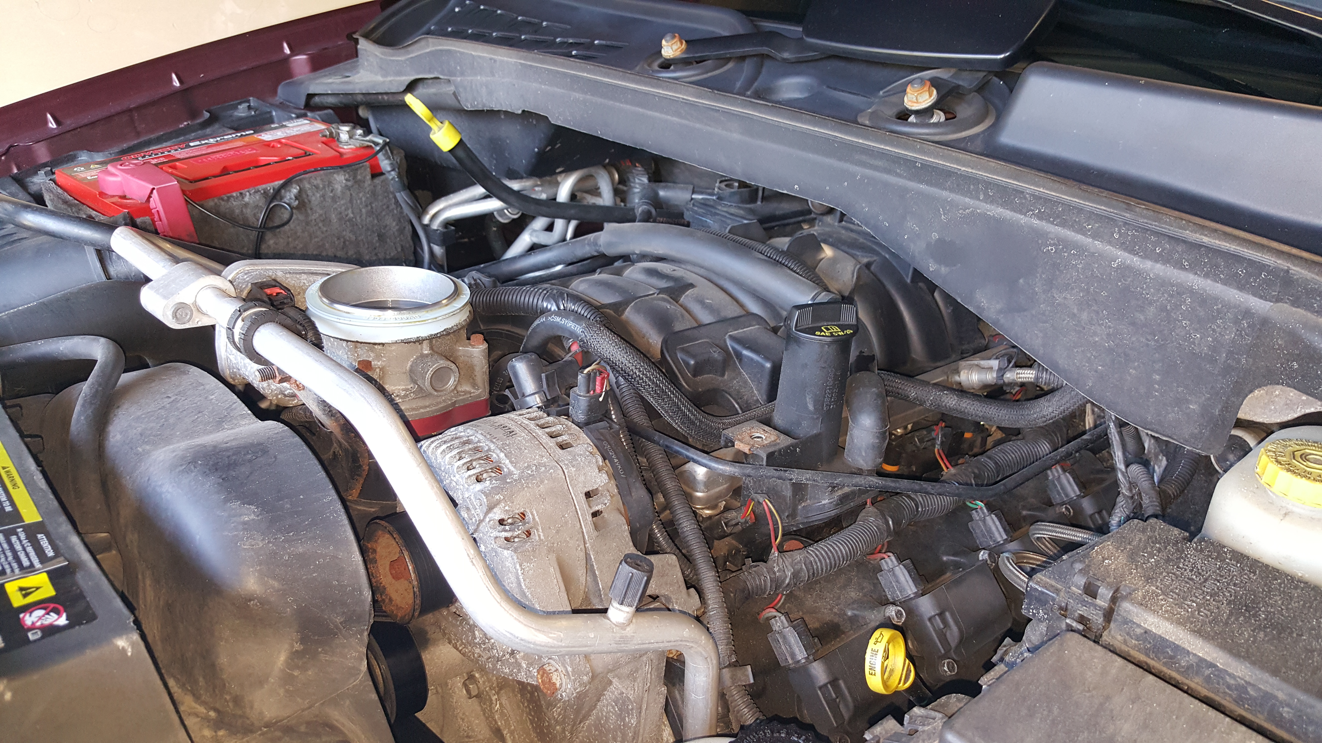

Looks like the biggest difference that I've notice so far is the angle of the throttle body opening and where the opening resides. It appears that your throttle body opening is set at an angle facing the front of the engine but the apparatus itself is set towards the rear of the intake (Back of the engine).
While, the one I have, the throttle body opening is set straight towards the sky and resides near the front of the intake/ front of the engine.
Is this what you see as well?
Attached Thumbnails Cold Air Intake for 2009 Aspen 5.7L-20170820_171121.jpg   Cold Air Intake for 2009 Aspen 5.7L-20170820_171132.jpg   Cold Air Intake for 2009 Aspen 5.7L-20170820_171643.jpg

Here is the last picture from this weekend, exhibiting the Throttle Body front center, with the opening facing straight up.
Old Aug 22, 2017 | 04:57 AM
  #25
calamity coyote's Avatar
Joined: Sep 2014
Posts: 417
From: Dallas, TX
OUCH! There is the difference we've been looking for. Yes, mine is towards the back by the firewall and aims straight forward. Sorry to say, but the kit for the 07-08 will not work with that. Simply does not bend that way. Kinda odd that they would change the TB for one year like that. Then again, they probably weren't expecting the Aspen to discontinue at the time either. Since it was only one year like that, this explains why no companies make a kit for it. Not enough demand.
