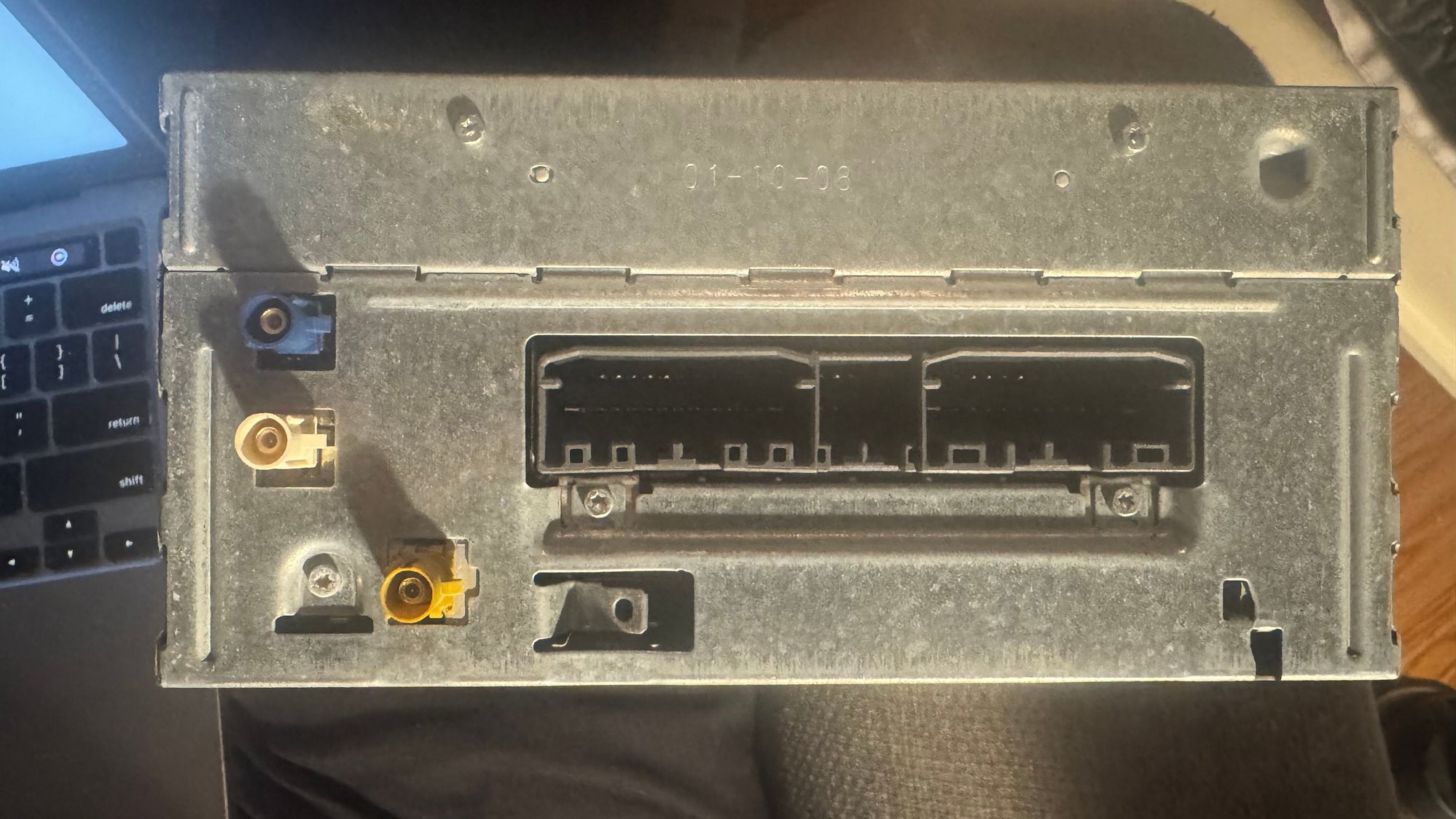

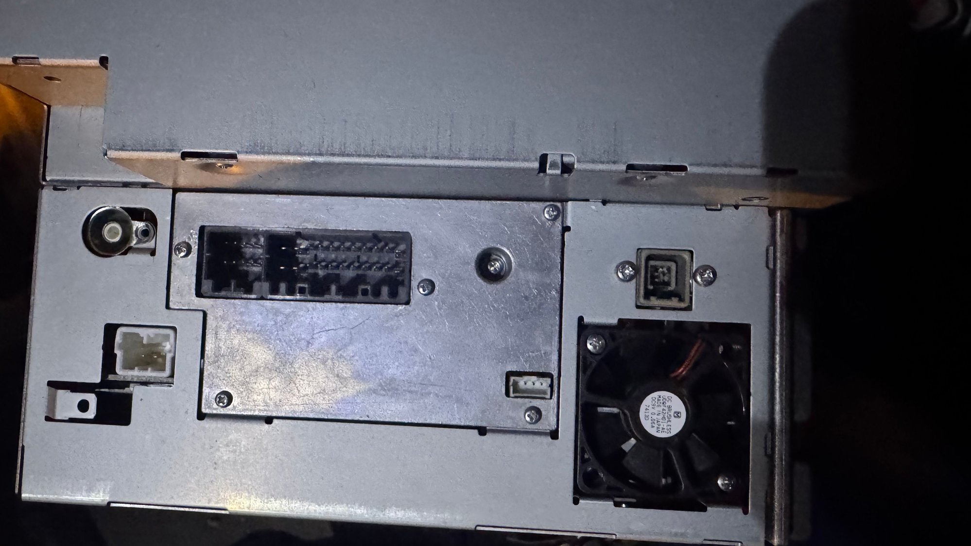

Help I have a 2007 Aspen I was trying to upgrade radio nav system to one I got out of a 2008 or 2009. Can anybody help me Please
2007
2008 or 2009

Help Please me I have a 2007 Aspen that I'm trying to upgrade the radio nav system with a 2008 or 9 Aspen radio nav system.
2007
2008 or 2009
