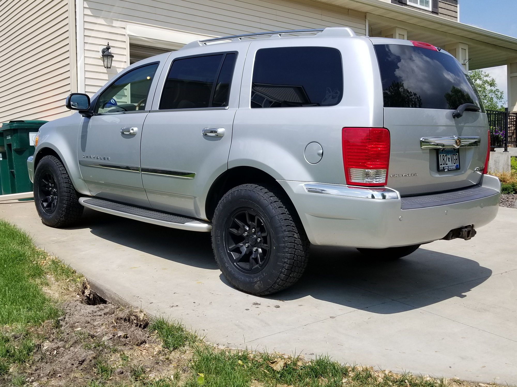

I'm not a fan of 20" wheels on trucks, I like a fluffier ride and tire.
I picked up a set of used Ram Rebel wheels and then bought some new Nitto Terragrapper G2 tires from DTD while they had the Memorial Day Sale.
Ram Rebel Wheels are 17x8 +18offset. (oem Aspen are 20x8 +35offset)
265/70/17 Tires are 31.4 OD (oem Aspen are 30.4)
With that said, these wheels are 1" larger in OD and stick out 17mm further. My Aspen is at stock height, and there is no rubbing.
Pics:

They look really good!

Thanks!
