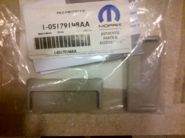

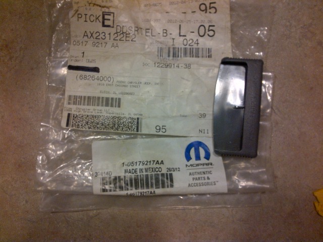

Here are the two that I purchased, you can see the Mopar numbers on the bags. One is gray, for my now gone 06 Durango and the other is tan for the Aspen.

The first photo shows part #05179217AA (Outer Belt Cinch Tongue Cover Repair Kit)
The second photo shows part #05179148AA (Outer Belt Cinch Tongue Cover Repair Kit)
These parts appear to be the same parts just different colors.
The best resource for parts questions is the Parts Department of your local dealership. They can ascertain the correct part number(s) to make sure the colors are correct for your interior, review part availability and discuss any alternatives you may have.

After doing a little more research, it appears from what I can see in our Parts Database that those parts "MAY" not be compatible with the 2008 model year Aspen. Looks like they are only compatible up to the 2006 model year.
Again, double check with the Parts Department of your local dealership to make sure you get what you need for your specific vehicle.
