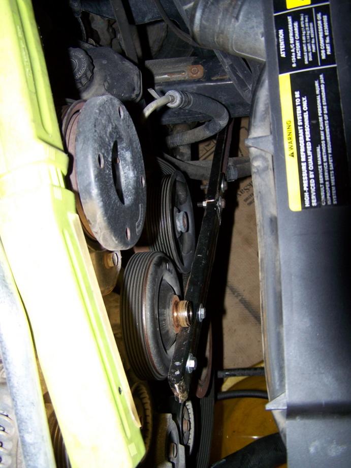

- install the pin spanner wrench from the driver's side from underneath. Place it over the power steering cooler lines and brace it against the frame. Takes a bit of finagling.
- from the driver’s side get a crescent wrench on the large nut and use a snipe (I used a large pipe) or wrench over wrench to turn the nut counter-clockwise (this is now correct) when facing the engine from the front.
- once the nut is loose it's a lot of wrench quarter turns with the pin spanner in place to get the fan off. Last few turns can be made by hand and should be made by hand so you don't drop the fan into the rad. Once loose lower the fan down. Undo the bolt for the fan shroud on the driver’s side (only 1 bolt) and push the other side out of its hole and pull the shroud and fan up together removing the fan once it's clear of the compartment. Then the shroud pulls out too. Don't force the shroud as I broke mine and had to repair it. Yes you need the shroud for cooling to work properly.

- place the pin spanner wrench in the water pump pulley holes but from the passenger side from underneath and brace against the other frame rail.
- slide the bottom of the shroud in and then the fan. Side both down into place and thread the fan nut onto the water pump. I pushed the fan in towards the pump and used the crescent to thread it on. Maybe you can do it by hand to get it started to avoid any cross treading. Once the nut is as tight as you can get it with the wrench only use a short snipe and the crescent from the driver’s side to apply that extra push to get it tight.

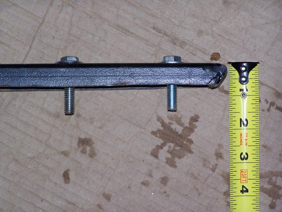

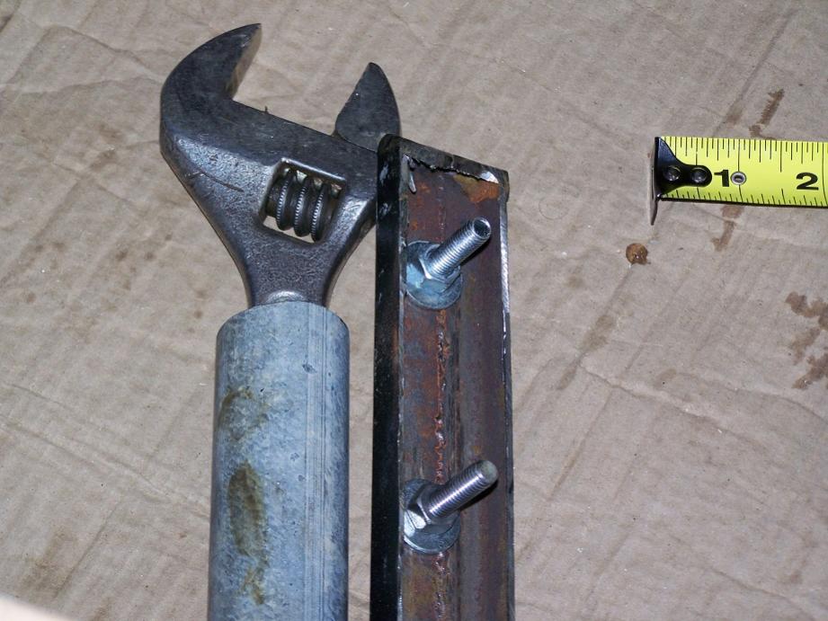

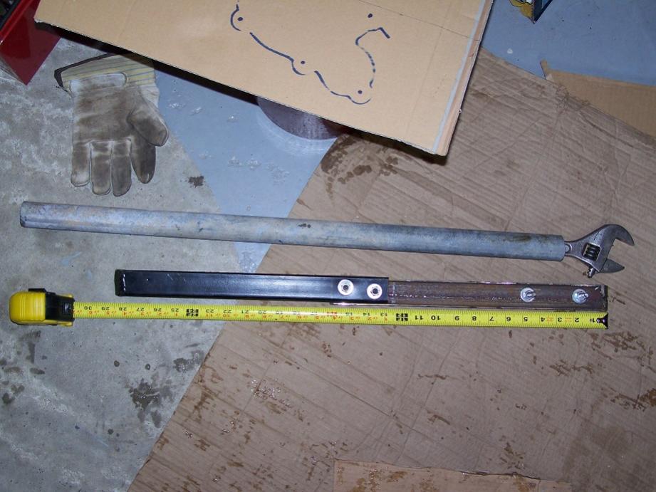

Pin Spanner wrench:
made from a chunk of 1" square tubing cut in half, you can use anything solid and strong. I found that 28" long was the right length for the wrench for bracing on the frame. I used 1 3/4" number 8 bolts, 3 1/16" apart. Anything longer in there might not work as it’s tight with the 1 3/4" bolts. Use washers and nuts to tighten on the handle. Use the belt tensioner to help align the bolt holes for both the loosening and tightening using the pin spanner.
Snipe for the crescent was a piece of galvanized steel from an old fence.

Whoops screwed up on the direction to loosen the large nut, should be counter-clockwise when facing the engine from the front. Clockwise to tighten.
