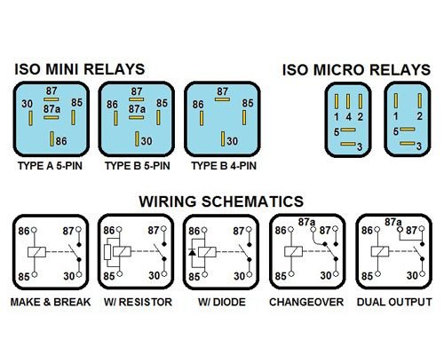

Old Apr 27, 2022 | 08:02 PM
remove the relay look at where the relay goes and look at this pic for reference. Put black lead on Negative ground or battery ground. then put the meter on Ohms then use the positive lead and probe pin 86 in the fuse box with the key off does it show OL or does it so numbers?
Old Apr 28, 2022 | 02:59 PM
Westm2413's Avatar
Joined: Apr 2022
Posts: 8
it shows OL
