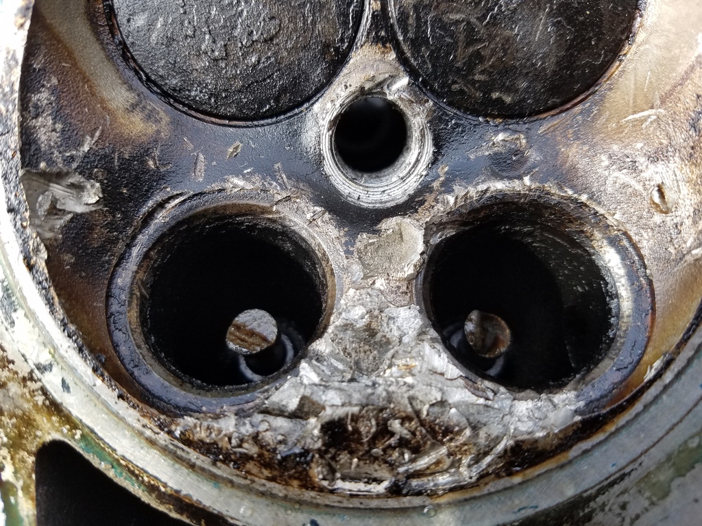

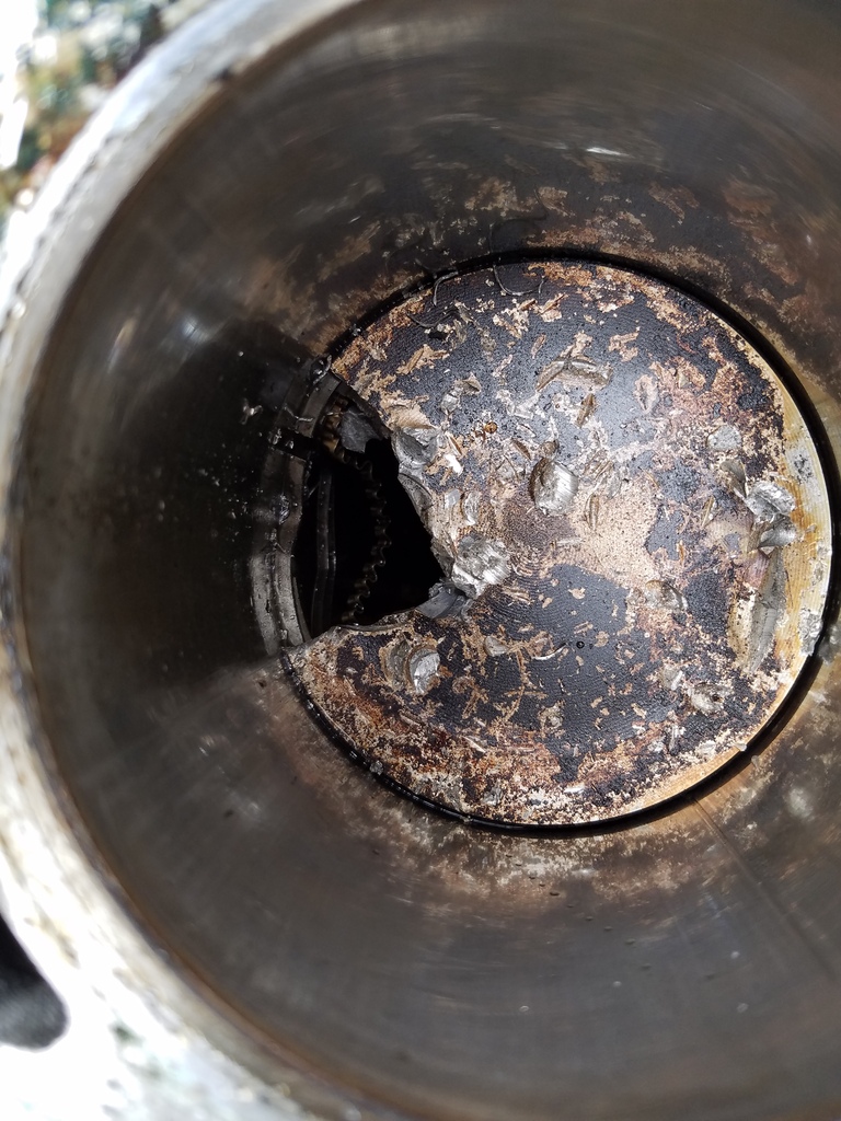

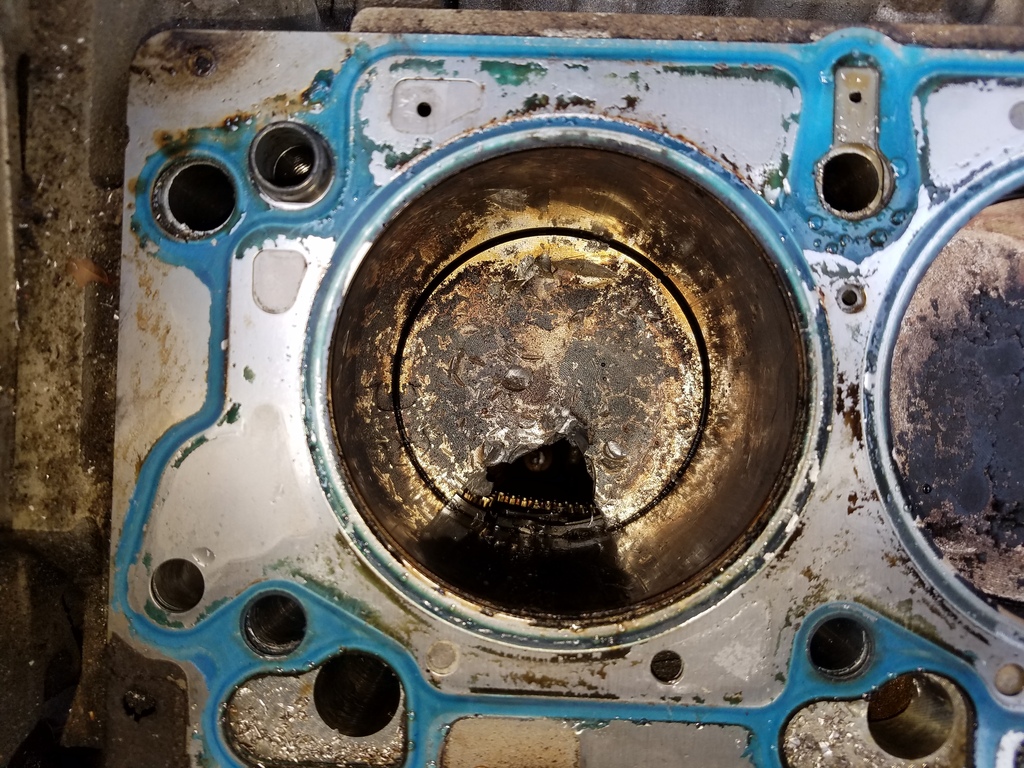

Guess it was more than a water pump job and didnt turn by hand when the belt was installed.....

Lol most definitely!....right now i have the new piston ready to be put in, i also have the old head off and the new One ready to install aside from swapping the crankshaft, but im about to run to the parts store ro get a new one real quick so i can get everything put back together, i also got new head gaskets....this is my first time being this far into the engine, and its quite the adventure haha....but so far everything has gone smooth

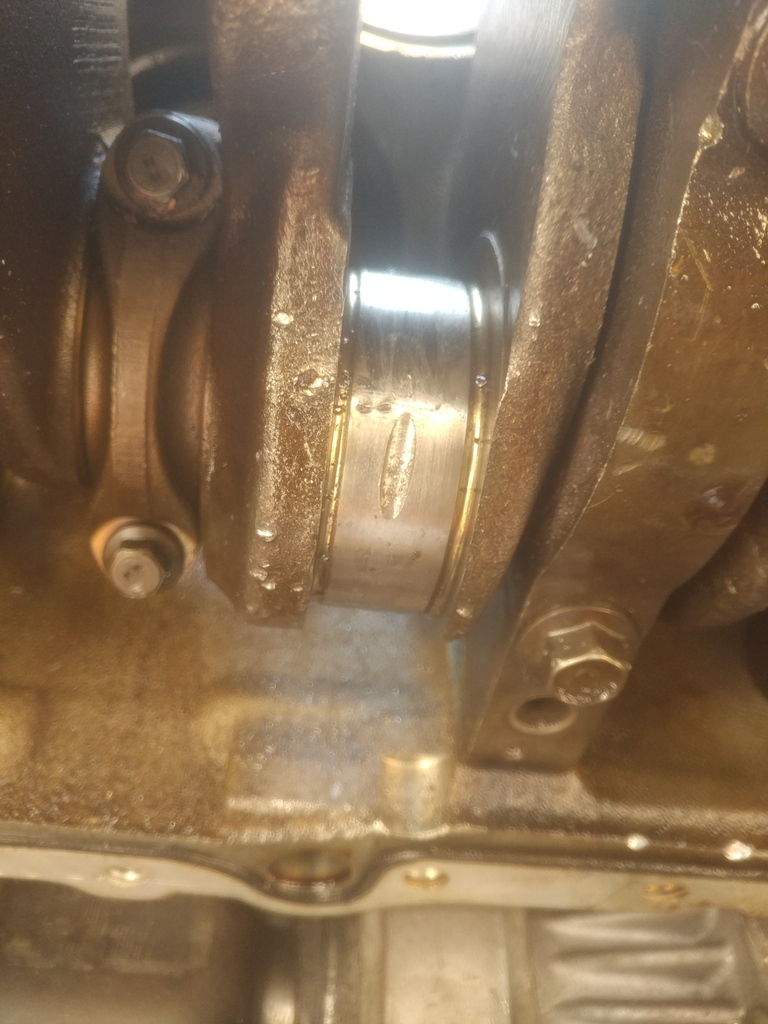

Posts: 30
So in the process of taking the piston out the two bolts for the connecting rod cap stripped out so i drilled them out and in the process of doing that i drilled through the bearing and took out a huge chunk of the journal on the crankshaft, is there something i can use to fill in the chunk that i took out with the drill bit? Or did i just screw myself completely? It took me 6 months to get this pacifica up and running and doing an engine swap and grt all the kinks worked out, ive drove it for about the past three months and now all of this happened because at first it started out being the water pump, then. I found the hole in the piston because i snapped a rocker arm bolt off in the head and tried.drilling it out and completely screwed that up so i replaced the head, which brings me to where im at now. If i have to replace the crankshaft i might as well do another engine swap right? If that's the case i think im just going to sell it as is wirh no engine and say screw it and try and find another car thats not a chrysler with a 3.5l

Kind of screwed, no way to repair crank, must be replaced.
