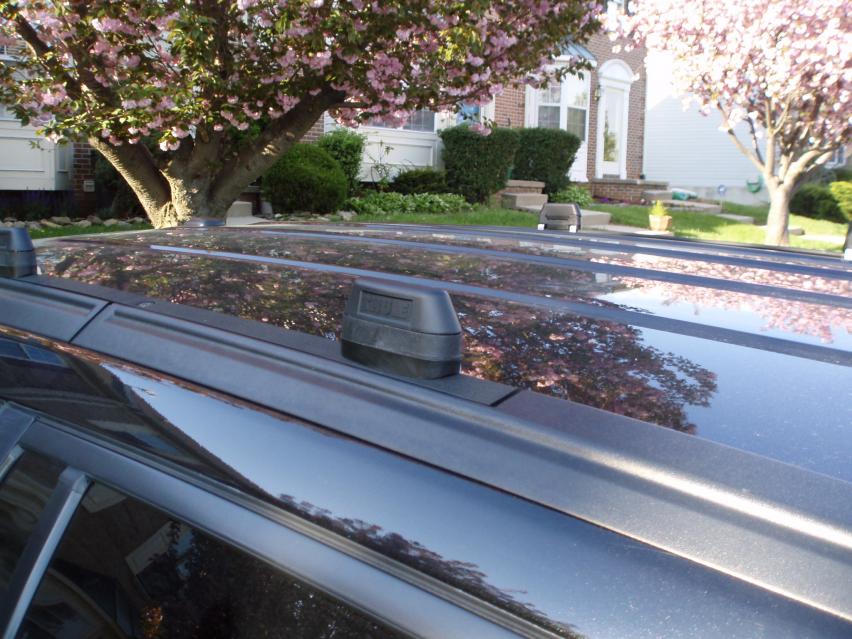

Heres some pics of the Thule rack and box.
Attached Thumbnails Sport Utility Cross Bars and Cargo Box-p4250003.jpg   Sport Utility Cross Bars and Cargo Box-p4250006.jpg   Sport Utility Cross Bars and Cargo Box-p4250008.jpg

Looks good , Pac2006.
I saw the same crossrail on a Pac last week in a parking lot, the guy had shortened the rails up so there was no overhang past the mounting blocks and powdercoated them black.
(yea, I know stalking pacs in the parking lot is bad, but i just had to see who manufactured them, because they looked like stock rails, but higher!)

Thanks. Thats funny, "stalking pacs". Thule makes the same bar in 47", but they don't recommend it. I will measure the minimum spacing needed. I was concerned with the bar length being overwhelming at first, but after putting them on and standing back I was happy (pac is wide). Powder coated black would look nice, and I thought about it as well. I only plan to use the rack when the cargo box is on, tho I am toying with the idea now. I will have to get some prices on the powder coating now. Or how about anodizing
