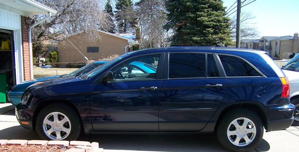

I have a 2006 Pacifica FWD. It is horrible in the snow (Michigan), but I still love it. Maybe I will get some new tires next winter. Or maybe I am spoiled, because my only other cars have been Grand Prixs that have done awesome in the snow. Anyways, I love my pacifica. I am tall, so it is perfect on head room. I was actually too tall for the fancy model with the leather interior and sunroof. The sunroof is a little lower than the actual roof and it hit my head when I was test driving it.
You can see my old grand prix in the back lol.

Nice Pacifica jzabi0079 ditch the Michelin's and go with some thing else and you will enjoy your ride much better I have good year assurance good for 65000 miles very nice and good grip in the winter (Illinois). I had a 02 Grand Prix that was awful in the snow and the traction control was not worth a crap, although I did have a 94 Grand Prix GTP in the past and traction was a lot better than these newer cars.
