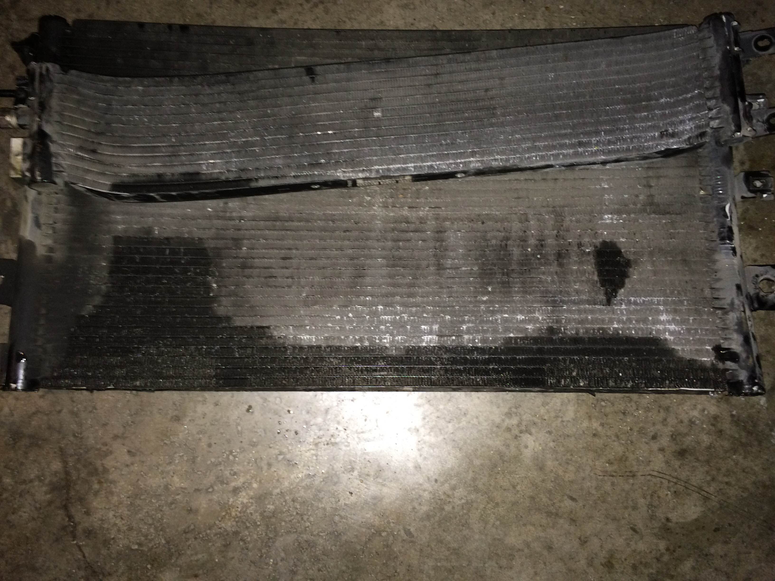

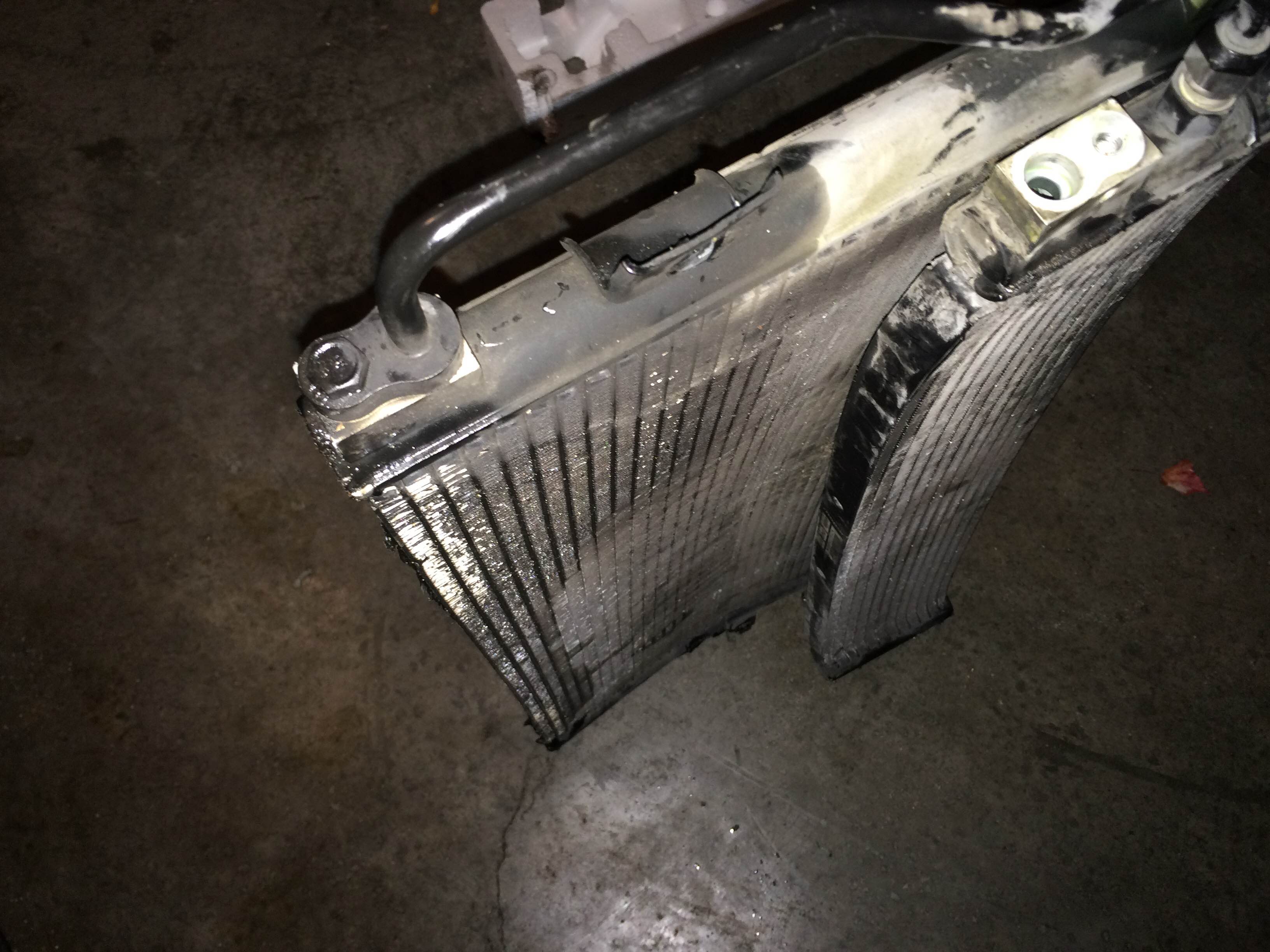

Our 1996 Chrysler Town and Country XLI 3.8 was involved in a fender bender accident. I pushed the grill in, damaged the radiator and the fan.
I took out the radiator, and I took the fan off the radiator. When I looked at the radiator I thought it was a three row radiator, and as I was removing what I thought was the rows, one of the hoses had transmission fluid in it.
So I googled it and I'm at the conclusion that it's an oil cooler that's connected to the radiator. I attached some photos to show the two extra rows that were connected to the radiator.
If one is the oil cooler, then what is the other one? I looked all over the Internet and couldn't find what the other one is.
Any advice or suggestions are welcome.
Thank you.

Look like Air Con fittings..

So I looked up Air conditioning cooler. I didn't find it, however I did find a Transmission Cooler.
Plumbing, Air Conditioning, 3.3L, 3.8L
I thought this was the same as the oil cooler?
Would it be ok to reuse the same fittings, and AC condenser?
Old Nov 18, 2015 | 04:53 PM
Jak98053's Avatar
Joined: Nov 2015
Nevermind Just looked this up on Rockauto and found the AC condenser, that is the third cooler I was looking for. Thanks!
Still would like to know if I could use the same hoses, and and AC accumulator.
