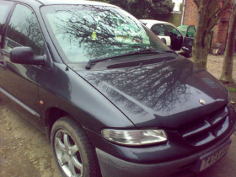

Hey there, well here goes!
I have just bought a Voyager SE 2.5 TD 1999,
I have NO HORN? NO Internal lights? NO main beam headlights only dipped work at the moment.
My wife being the superstar she is has managed to find a manual/service guide for a 98 Voyager, which so far has helped me to get power to the glow plugs, (the relay had corroded and was u/s plus all connectors had disintergrated).
From what I can gather from taking the connectors off of the horns the green/red wire goes to a relay connector next to the glow plug relay, but there is NO relay there??
I honestly dont know where its gone as i've only had the car two days so far and it wasnt there when i first opened the bonnet?!?
But the thing thats puzzling me the most at the moment is there are no internal lights working, have pulled a few bulbs and they all seem fine, doesn't seem to be any power getting there, am i right in thinking that the internal lights should come on when you open the drivers door? or if you've left the headlights on and then open the door you should hear a warning sound?
Any help would be greatly received as I need to get the car through the MOT to put it on the road because we have 5 children and a two week school holiday is upon us!!! you can see my dliema!
