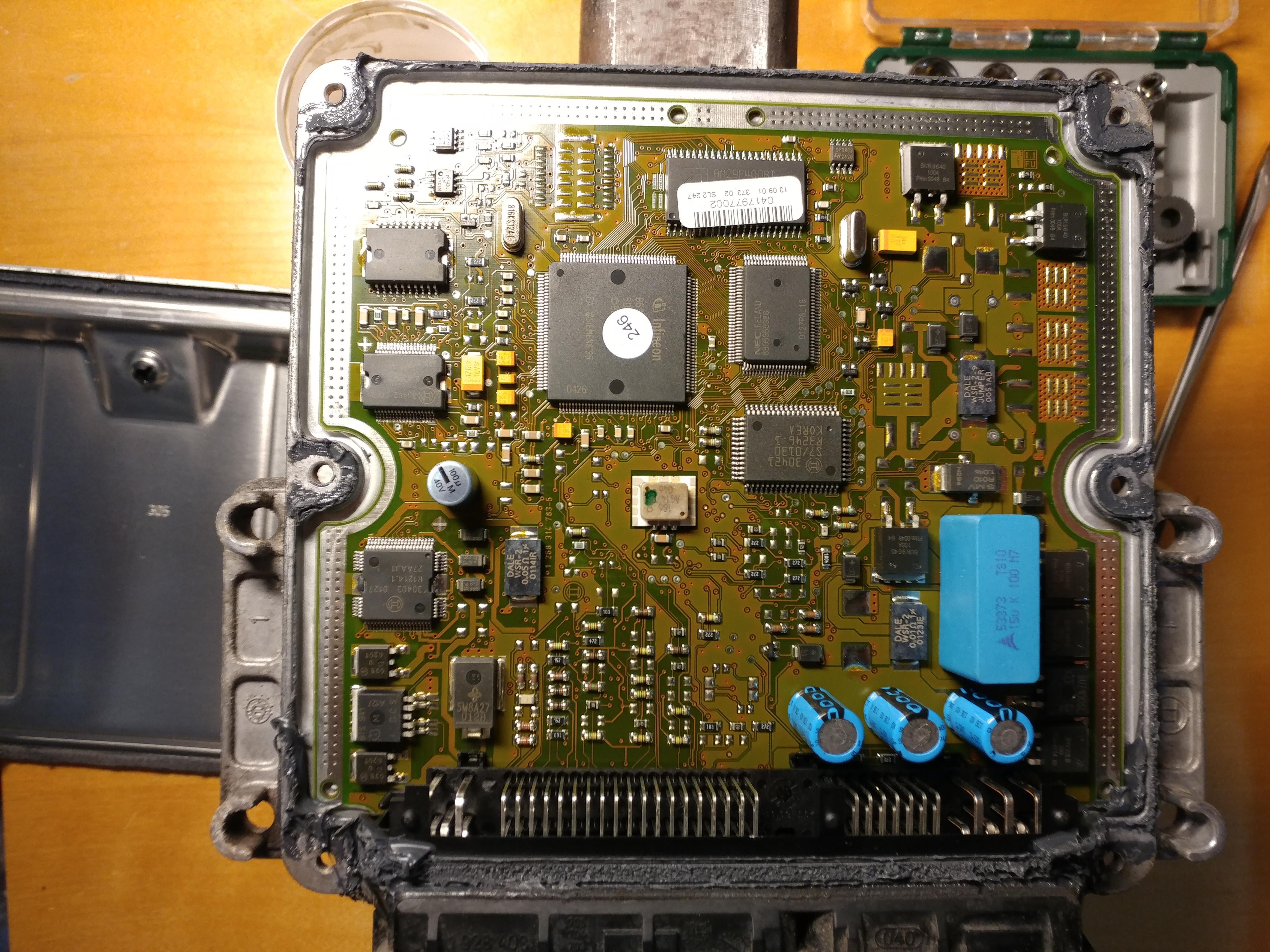

Only thing I can think of the the ECM not sending signal. The blown fuses were the IGN of IOD/BATT and one park light fuse.
I am guessing current surge zapped the ECM and a couple of other circuits.
Would you guys agree with this logic?

Photos show inside of the ECM.

Hmm, that is a strange one. I think you've done a lot of the diagnostics there and I think I'd be heading towards the same conclusion, except I'd expect more not to work if the ECU was fried, I am not sure exactly if it would turn the starter over or not (Car immobiliser I think is the BCM not ECU, ECU dedicated only to engine management, timing, etc).
Testing the ECU is also not easily done without complex diagnostic kit, you might be better off searching online for one of the services where you can ship it to them for replacement/repair or reprogramming.
I'm going to assume you've done the basics first, pulled the battery for a couple of hours to let it fully reset the car, then when you put key in does the immobiliser light go out? (That's a thought, could the immobiliser be disabling the car?)
Sorry it's not a solution, just another few thoughts that might help! Good luck with it.

Hi Andy, Yep, I had a look at the diagnostics and the SKIM (immobilizer, key ignition controller) is tied into the ECM. This means that one cannot just replace the ECM as the two controllers validate VIN and secret keys etc prior to successful ignition. What a pitb...! Next step is to check the harness wiring to the injectors. If that checks out, then it must be the ECM which I can send to an outfit for copying into a different used working ECM so that the secret key and vin are copied over. Cost about 150-200gbp. And then one hopes for no more failures...! I'll also check out your theory about residual currents and potentials screwing up the car and attempt a restart this pm. TY, kkc.
