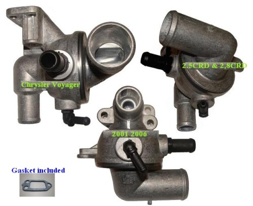

Right - definitive information about the thermostat for the CRD.
I now have in front of me, two brand new thermostats:
1 - part number 05083288AA, to fit a 2002 onwards 2.5/2.8CRD, bought on ebay (currently available from a Latvian seller for about £65 including postage - seller is reliable as that's where I got this one from) Thermostat is made by Behr and the Behr part number is C.939.88 and includes the gasket.
2. part number 05066808AB, to fit a 2001 2.5 CRD – bought from Chrysler today for about £140, including gasket. The thermostat is also manufactured by Behr (clearly marked on the housing).
Apart from the wildly different price tags, the housings are identical. The only difference is that the later thermostat has a small right angled plastic tube screwed into on side of the body (visible in the lower middle picture below)– on the earlier thermostat, there is simply a blanking bolt screwed into the housing in place of the tube.
Otherwise they seem to be identical – if I had been able to compare these parts without buying the Chrysler part, I’d have been quite happy to buy the thermostat from ebay and replace the plastic tube with the bolt from the thermostat about to be removed.

After an exchange of messages with voyager_dan, we agreed that if I provided the parts (about £60 for his, and £140 for mine - for essentially the same part, mande by the same company), he'd provide the labour (with me helping as much as possible - which may have been a hinderance) and last weekend, I drove down to his place so that we could swap both thermostats out. Started with mine, andit came apart nicely - the longest time being cleaning the old gasket off the engine (not easy to access), and the most surprising part for me being how easy it was to remove the whole wiper mechanism and tray (about 10 minutes perhaps). On taking out the old thermostat, and comparing the new, it was immediately apparent that the old thermostat was stuck open as we could see much more of the brass shaft inside. All went back together nicely, and total time was around 3 hours. Ran the engine and for the first time since I got the car, I was getting very hot air inside - what a luxury - and the temp gauge went up to just below the halfway mark, and stayed there.
So then we started on Dan's car, thinking that as we now had the experience, this would be much quicker. Unfortunately, tiny design changes put an end to that idea - we ended up taking his apart less than mine, but it did mean that trying to get the new thermostat installed was much trickier (campared his old and new thermostats, and again, obvious that the old one was stuck open)- I think if we did it again, I would be inclined to use a setting gasket compound to well and truly stick the gasket to the thermostat before I even started the job, but we finally completed this one (2002 model, mine is a 2001 model) also in about 3 hours, and it warmed up nicely (once Dan had removed an airlock).
If anyone is contemplating doing this, the labour saving makes it worth doing it yourself. The thermostat is currently available on ebay from Latvia for around £60, and that's where I got Dan's from (mine only came from Chrysler because I couldn't be sure what the differences were), and you definitely need the remote clip removal tool (about £40). Otherwise, pick a warm day if possible just because it's nicer and save yourself hundreds of pounds.
