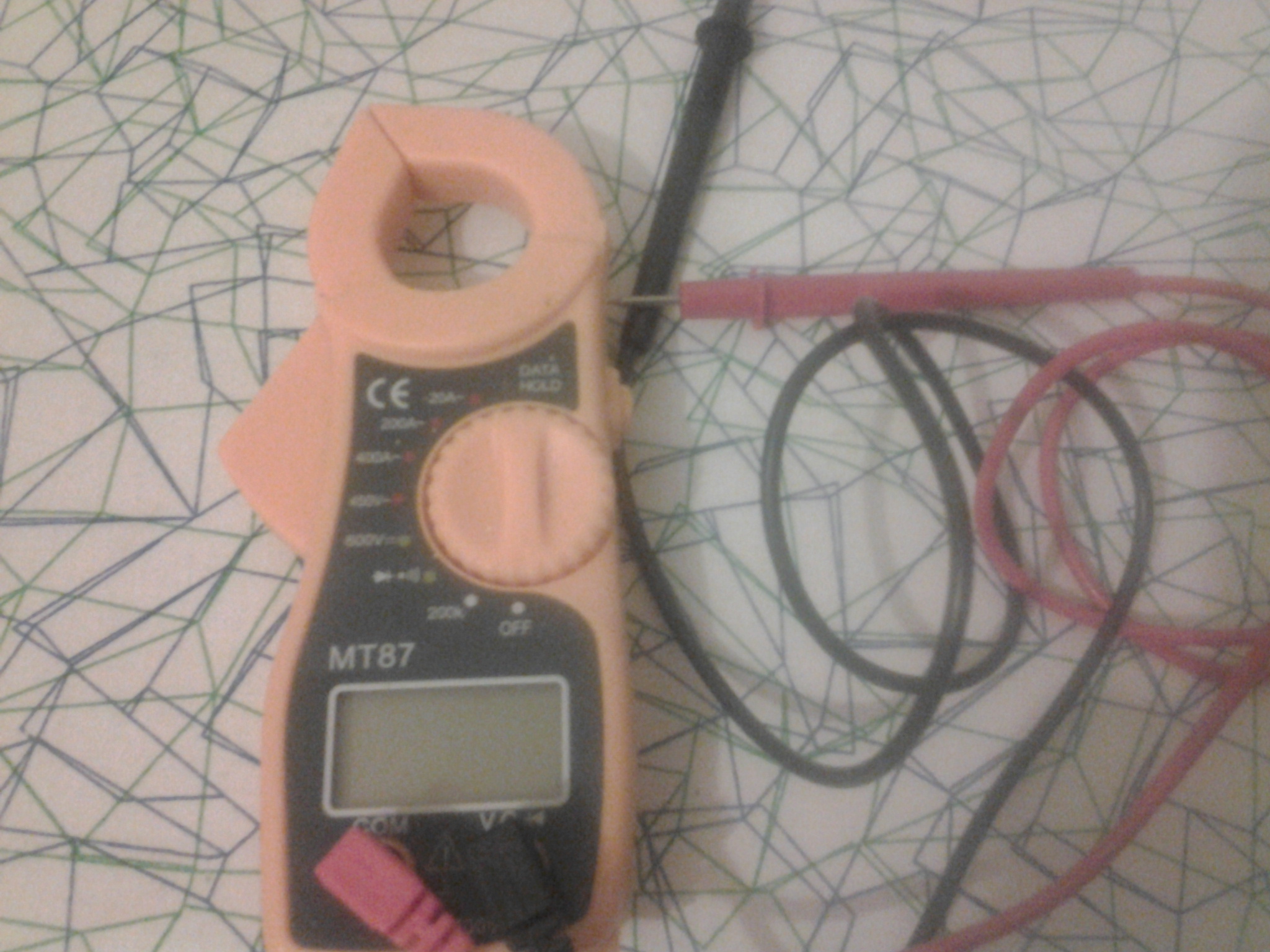

This is what I have

Beautiful. Is the 2.5 engine simiar to the 2.8 and will glow plugs be in similar places. Whats the name of your multimeter? I bought 1 last year but apparently it no good for car work
How about you make a vid for injectors ? Please sir
When I had the 2.5, the glow plugs were in the same position and were testable the same way.
A basic multimeter will let you test most stuff, here's one for £3.11.
Digital Multimeter LCD Display AC DC Volt Amp Ohm Transistor Tester DT-830B | eBay
Having removed a few injectors in my time, you need a 10mm socket to remove the clamp bolt, an injector removal tool, and most likely a 2ft breaker bar and a 30mm socket. A ratchet and 30mm socket works with a scaffold pole as well.

Thanks for the multimeter link. The reason I wanted a video is because I am nog sure which are the injectors you see. Everything I now know about cars has been through this and mercedes forum and I am still learning. Ordering multimeter now

Measuring by calculating the magnetic field strength around a wire needs the wire to be in very close proximity to the cable, this 'hall effect' type meter is not particularly accurate but good enough for most non-low current [example - parasympathetic loss] 12v DC purposes. You don't need a fancy autoranging meter a
cheepo cheepo
LidL: £5 job will do just as good for these purposes.

It might take a wee while as it comes from China, but well worth having. (QinteQ has linked to the same metre from Amazon, might be a quicker option).

Keep an eye on LidL or Aldi, they sell at £5 when in stock, job dome !
