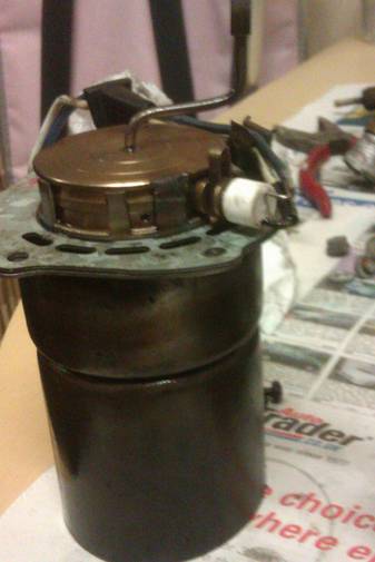

Hi, extra point here but lets start. Gauge only going to 1/4 means you need a new Thermostat unit costing around £60 from latvia and as said it is the right unit as fitted by Chrysler. As too the ticking these guys on hear have given the answer, Aux-heater, even said why it ticks, bloody hell their good, even I'm impressed.
Now I'd advise you to remove it as I almost knackered my engine when I drove it away one night not realising I had left alot of coolant on the driveway. Found on stripping unit down (pictures I'll try and get on here) the heat exchanger had fractured and well the coolant was leaking out. Drove car back with temp gauge in red for a good few miles, think I'm lucky its ok.
Anyway I dropped heater with its tray after draining coolant via the two hoses conected to it and disconnected the power plug. The heater was then unscrewed off the tray, (2 screws sheared off). I then bought a meter of coolant hose from my motorfactors, connected it to the pipes from the engine using same clips and secured this loop of hose in the tray to same position below car. Tied power plug up below after sealing contacts.
No indication comes up on dash as to it being missing. Have noticed replacement heat exchangers on E-Bay from same Latvia soarce.
Think I got it all.
Will try for pics separately.
Goggs...
Old Mar 26, 2013 | 03:23 PM
  #16
Default Pictures of heater..

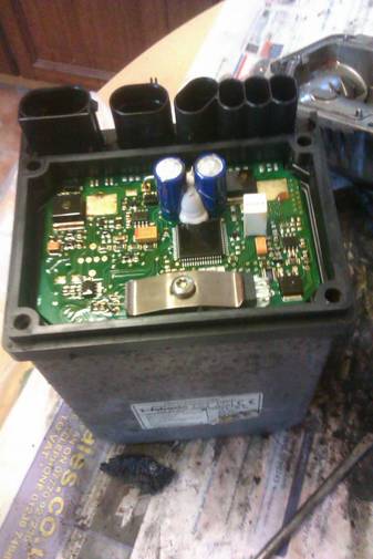

Hi, lets try. One picture shows heater on tray. One shows heat exchanger inside it. Another electronics. Think you'll recognise the firing head.
Goggs..
Attached Thumbnails 2003 Voyager SE 2.5TD - Strange "Ticking Noise"...is it a Bomb?? lol-aux-heater-2a.jpg   2003 Voyager SE 2.5TD - Strange "Ticking Noise"...is it a Bomb?? lol-aux-heater-3.jpg   2003 Voyager SE 2.5TD - Strange "Ticking Noise"...is it a Bomb?? lol-aux-heater-2.jpg   2003 Voyager SE 2.5TD - Strange "Ticking Noise"...is it a Bomb?? lol-aux-heater-5.jpg
