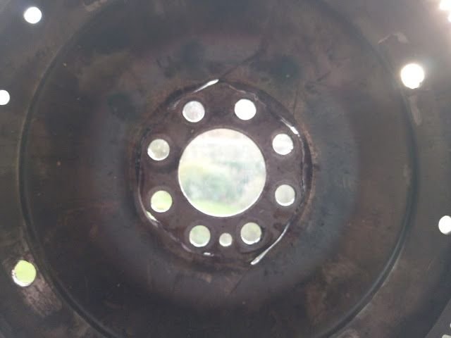

Default I've replaced 2 in the last 9 months
I've had my van looked at by the dealer and two other mechanics. They told me it was a common issue once you hit 120,000 and best bet was to find a new vehicle which sucks. I which crysler would improve the part at least.
This photo is of the one just replaced only lasted 9 months there's something wrong with the plates not the engine I've never been in an accident in it

i still say the issues is the mating of the trans to the engine. i believe one or the other is not square to the other part. and i would say the trans as the engine has to many alignment points during mfg. to get off alignment, the cam bore the crank bore the cylinders etc. the trans has the bore and the porting which might all be in one machine pulse the facing off of the mating surface to the engine. and if they are not perfect you still can't tell by the axles as the cv joints accommodate that alignment issue.
i have had cars with 250k on them and still the original flex plate. in fact i have not heard of flex plate issues like this, only the ring gears on some wearing out. not to much on the plate cracking at the mount. on the crank. only a misalignment would cause this.

Ah that picture of the flexplate looks like what mine was like, that was 120,000miles approx on the clock, and it hadn't been replaced before on my vehicle.
This was my flexplate that I removed.
Looks very similar to yours, except yours only did a fraction of the time mine took. How many miles did you do in that 9 months?
(Full post on the work Andy Brown's blog: Chrysler Grand Voyager flexplate replacement )
I initially didn't think 120k miles was a problem for the plate, but I've not got much frame of reference when it comes to autobox cars and mileage.
