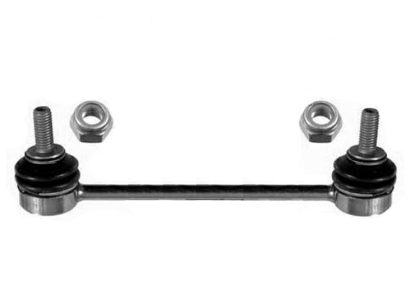

So I bought the 03. Got it for 1000. A few minor problems, I hope. Drivers and passenger windows wont go down . Tailgate only opens with the key. Moonroof wont open. Sliding doors seem kinda tight, maybe just need to be lubed. Lots of oil leaks. Looks like valve cover gaskets, tranny gasket. But my main concern is a clanking in the front over mainly rough roads, smooth roads no noise. They had a reciept for sway bar bushing kit, so I'm kinda concerned about this one. I didn't hear it on my test drive. So any thoughts?

I had the same, I replaced sway bar bushings (50% less "clunck") the the stabilizer arms (?) (dunno what its called in english ) > 99% less clunck..
