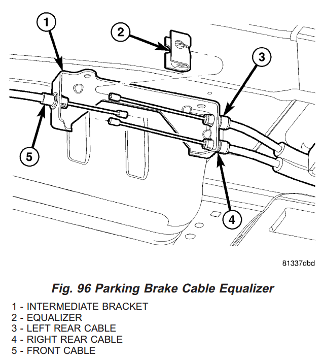

The whole entire service & maintenance thing including exploded pictorials is in sec 5 - 64 of of the 2005-RG-SM.pdf
Best of luck.
