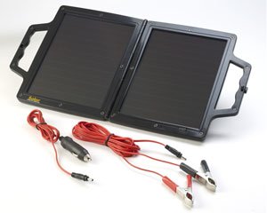

- I bought [cheap as chips] one of these, never had a problem since
- £11.20, and I keep the £380 in my pocket and avoid sending the 'logic' sensors do-lally !

and it worked for me in the LHS direct to pole socket, in fact its permanent, just sits on the windscreen and soaks in the sun even on winters days, as I said I'll stick my fluke on it and see what numbers [on mine] there are.
