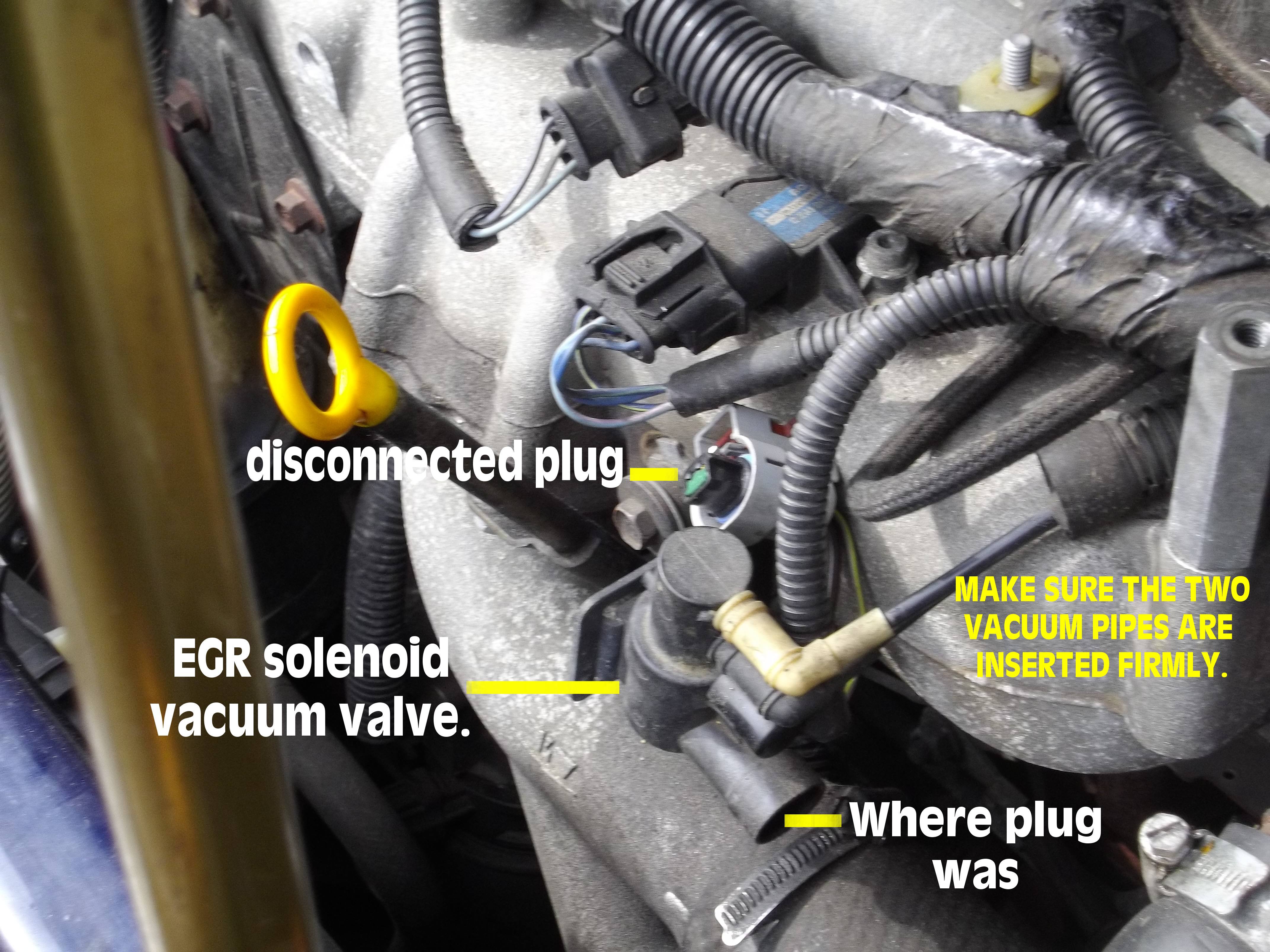

For the time it took to disable EGR (i.e. disconnecting the electrical drive to the vacuum valve at front of the 2.8 diesel engine controlling EGR), this has been the most cost-effective and easy fuel consumption improvement I've ever done. The second was blowing up the front tyres to 42PSI.

A long time disciple of both thanks for the tests and the objective outcome[s]. I had no idea that the mere 'disconnecting the electrical drive to the vacuum valve at front of the 2.8 diesel engine controlling EGR' would without a physical blank plate work. Showing a photo pointing to the disconnect you used would be helpful my Yorkshire friend. Congratulations on more MPG.

I'll try to get a picture of EGR vacuum valve to the forum asap., I've allsorts on my plate ATM, inc. an oil change I've just done with Comma allegedly full synthetic 5W30 at £20:00 for 5litre. Actually, the vacuum valve you can't miss really, its right in front of you as you look at the engine (with plastic cover removed). It has two black plastic pipes to it, say around quarter inch dia. one thicker than the other.The plug is only 2-pin.

I think I should point out that if you have a faulty/stuck/oiled up EGR physical valve (not the vacuum valve under micro. control I've been dealing with), disconnecting said vacuum valve will have no effect, as the physical valve is likely to be stuck open. Therefore there is no control, therefore unplugging/disconnecting the vacuum valve can't do anything. If your EGR physical valve is malfunctioning due to carbon, oil, dirt foulup, you'll have to fix it first. It means the EGR is in operation when it shouldn't be, i.e. during idling and full power. The EGR should only work at modest engine power, as vacuum is measured measured by the micro., the micro thus controlling the EGR action with the vacuum valve. Put simply, moderate manifold depression brings EGR into operation. Strong depression (=idle) or actual pressure from the turbocharger (=full power) does not.

I'm still not clear as too EGR condition without the vacuum. As a few months ago someone on here said the EGR is open when engine dead and no vacuum to it. So I take it Vacuum closes the valve as in power conditions.
So on isolating the Vacuum valve by disconnecting the power, does that let the vacuum pass through it permanently to close the EGR.
You will see here this is to be clear as someone's pipework and EGR maybe blocked giving us a false answer.
There's probably a schematic somewhere to clarify the operation.

Leedsman did you manage to get us a couple of pics for this mod. Thanks in advance mate

Default Vacuum valve.
Here's a picture of the vacuum valve. Do bear in mind this is the 2.8 diesel, it may be different in others.

I will try it this weekend, if its similar i will be very chuffed
