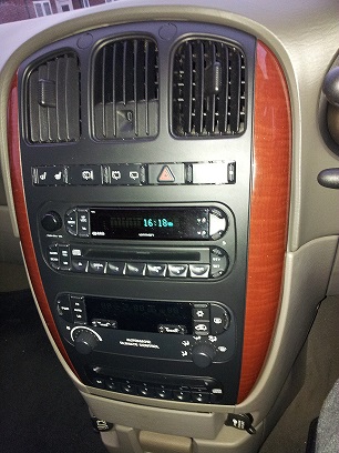

To avoid confusion for everyone, the cabin heater is the thing under the car called a Webasto, the controls for cabin heat should in this context be called 'climate control'. Mopar call the unit an a/c and heater control. the pic from ebay is rubbish but will do for this purpose, I might photograph my own {{edit changed pic}} and edit this post later so we are all on exactly the same page.
I've just run a test for fragmented. Mine is set to auto by which I mean the three toggle switches [high / low fan speed / passenger 60°C driver 60°C] but the fan speed and air direction ***** were not touched as they are controlled by the climate control[er], the unit was on and the squiggly lines were there. I travelled until the water temp was 1/2 and the cabin temp was about stifling. I then switched the unit off with the power [PWR] switch off and turned the IGN off. Turned the IGN on and stared the car, then switched on the climate control the squiggly lines were now not lit, and the climate control heater as expected worked ok with engine heat only and the Webasto turned off.
