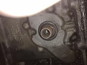

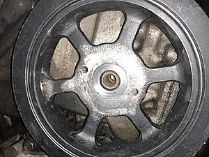

I picked up a 1998 Town and Country 3.8. The problem is the harmonic balancer. Do I have the wrong one? Is the crank shaft shot? Has anyone had this problem and what is the fix. What can you tell from the pictures?

I'm new, too and it's been years since I did one. Has the sleeve pulled out of the balancer? Are you sure you were pushing against the end of the crank with the puller? I doubt you've damaged the crankshaft, but getting that piece out will be tricky.

How about weld the wheel on and pull the whole thing of . The heat from the welding might help it to come of .

Here is a little history on the car. It belonged a friend of mine, 2 years ago he had the pulley fall off, took it to a shop for repair. Unfortunately he drove the car too long with a wobbly pulley and ground down the end of the crank. I bought the car for $100. There is 113K on the engine. It starts, its straight and everything seems in pretty good condition. It was his daily driver and maintenance was up to date at the time of the harmonic balancer fail. So the car has just been sitting for the last 2 years. Has anyone herd of welding the harmonic balancer on the crank? How hard is to pull the engine to replace the crank, or can the crank be replaced without pulling the engine. A new crank isn’t that expensive but I’m thinking its a lot of work. I want to get the car on the road. Is there another harmonic balancer with a smaller internal diameter that could be used on the crank end? I know if I weld the balancer on any failure will destroy the engine if anything else goes wrong with the front end of the motor. The issue isn’t getting the pulley off but keeping it on.

The rusty thing on the crankshaft is a pice of the balancer so if you weld the wheel back on the stud/sleve and pull the whole thing of you are good and mount a new/other one.
The balancer is sealing against the packring on the cover. The crankshaft is behind , the only thing of the crankshaft you can see is the thread to the center bolt.

The rusty thing is not a part of the crank !

mabye if you pry off the seal you get the sleeve of .
