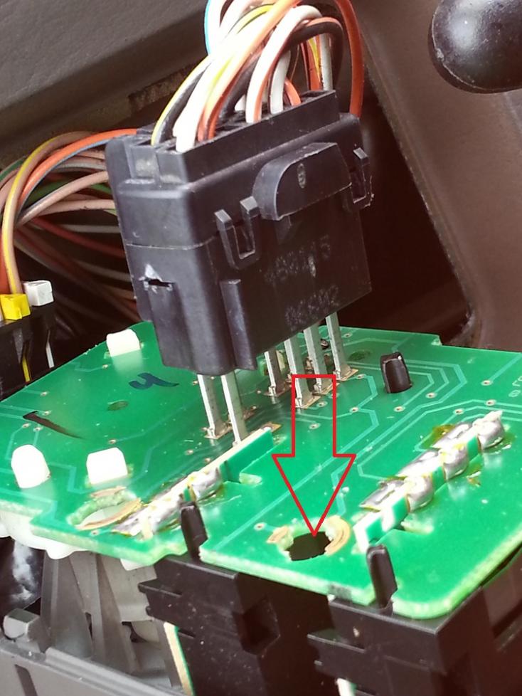

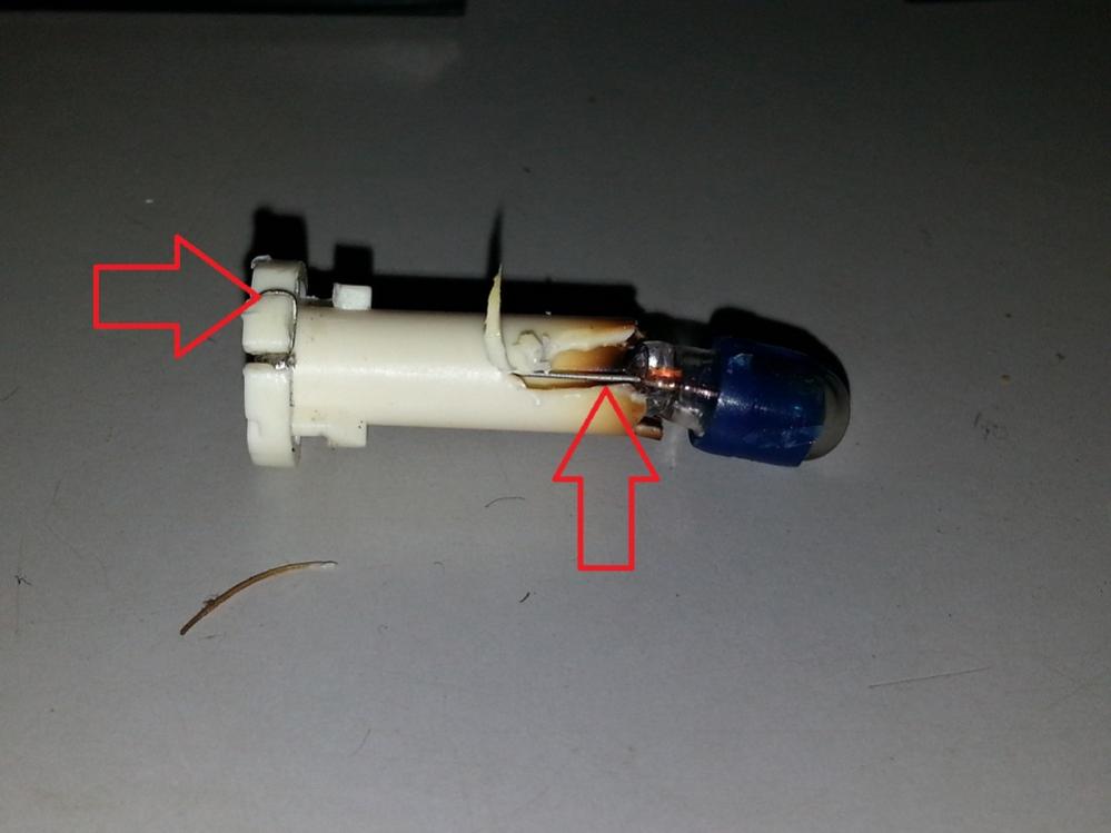

Found some more pics.
1 of the backside of the light switch panel (arrow points to foot of bulb holder)
And one of the bulb with arrow pointing to the metal strips you can "unwrap" so you can replace the bulb in the holder.
Attached Thumbnails Illuminated Lights-bulbs.jpg   Illuminated Lights-backside.jpg
