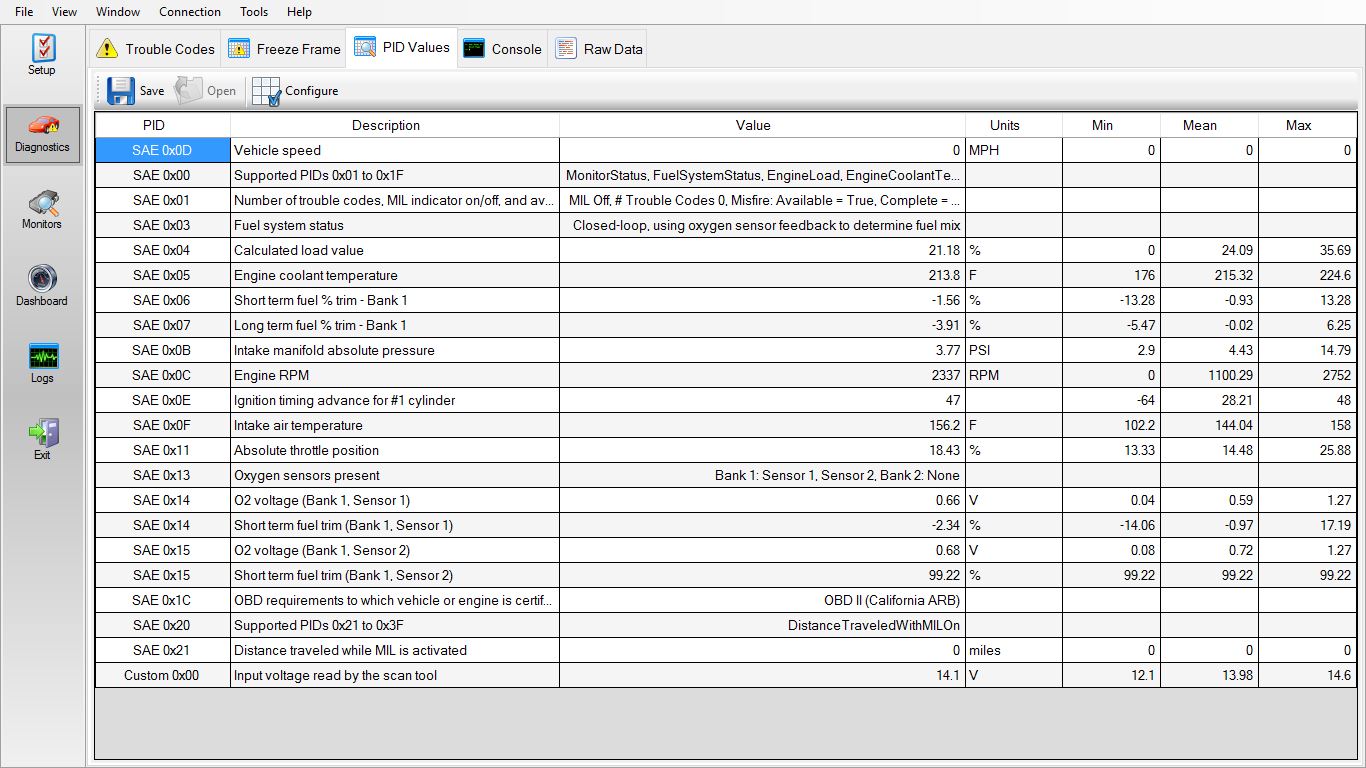

I'm leaning towards converter because of the varying monitor voltage but what do you think? See attached screenshots.
For a while it looked like the upstream wasn't switching as fast as it should but it did once warmed up.

Am I right in saying sensor 2 looks naff...
