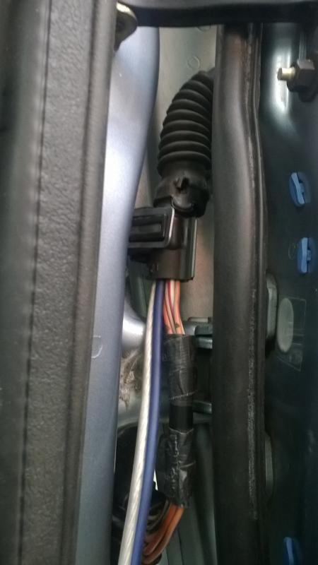

Speaker wire coming from door --

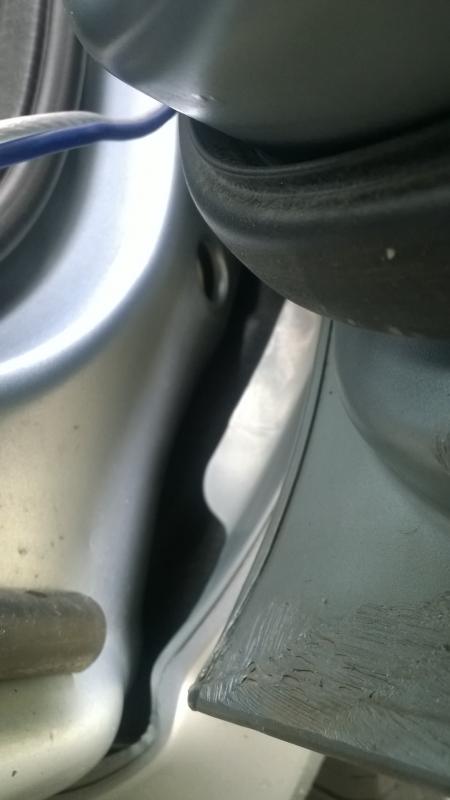

The hole used to feed it into kick panel --

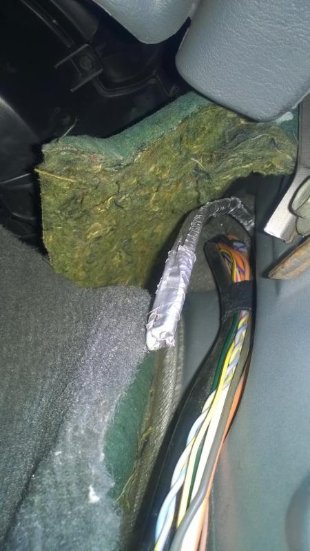

Speaker wire taped to hanger to assist in routing through expanding foam in kick panel cavity:

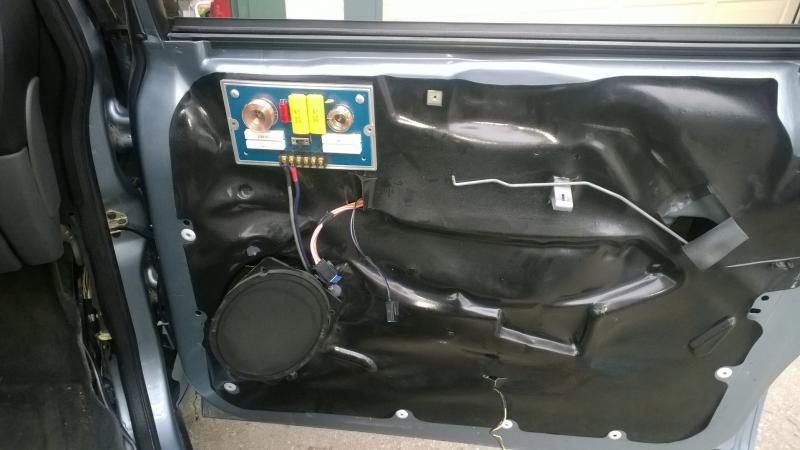

Crossover location -- before 6.5" installation:
