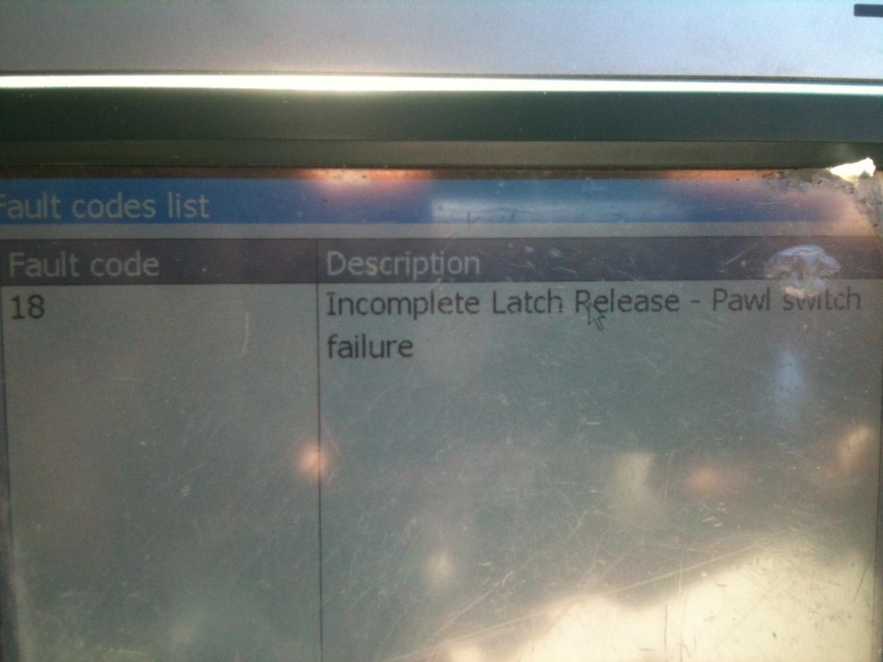

Hi, had it on a computer it suggests the Pawl Switch, does that sound about right?
Ok, here is your Jeopardy final round bonus question.....
Name the mechanical device that houses the Pawl switch?????
"WHAT IS A LATCH"
Replace the latch assembly

Default Pawl Switch
if u give them your vin they will see which one u need there is only one for the lift gate
This is what comes up after diagnosis. Chrysler have sent me back and forth with trying to obtain parts for this
