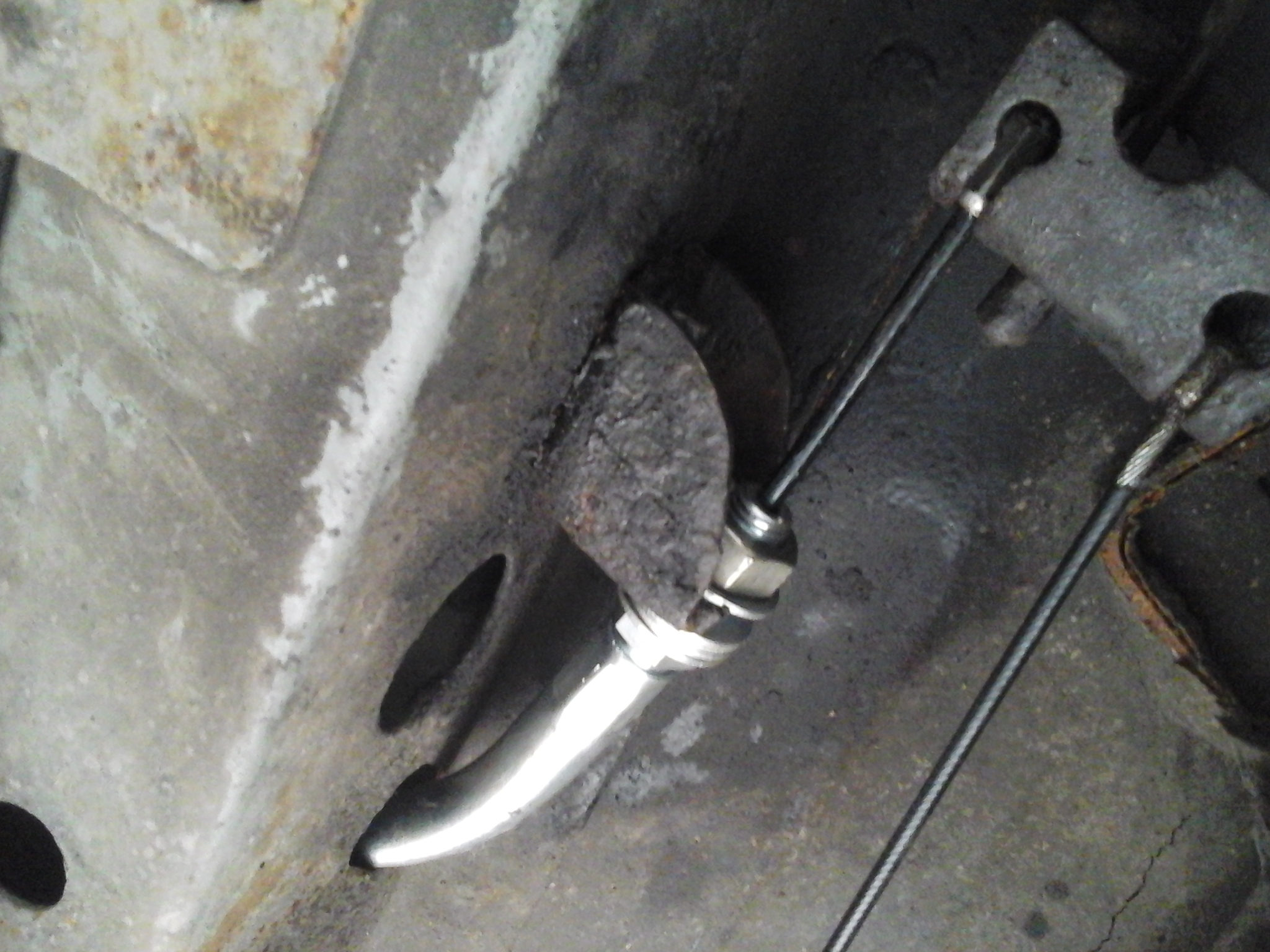

Not sure if your Handbrake is same as my 2003 model but anyway should help most.
The full release of handbrake cable in a nutshell. Start at handbrake and lockit up Loose. If you ever wondered what the slots were for on the handbrake mount this is it. Think I used a 5mm drill but Chrysler must use something prettier. With handbrake locked back you can strip fulcrum where handbrake cable joins drum cables. Now your drum should come off...See pictures.
Attached Thumbnails Rear Brake Disc/Drum Removal-chrysler-voyager-handbrake-2.jpg   Rear Brake Disc/Drum Removal-chrysler-voyager-handbrake-1.png   Rear Brake Disc/Drum Removal-chrysler-voyager-handbrake-3.jpg   Rear Brake Disc/Drum Removal-chrysler-voyager-handbrake-4.jpg
Old May 5, 2016 | 07:09 AM
Thanks goggsy but the shoes aren't binding on the drum preventing the drum from coming off, the drum spins freely when the handbrake is released, it seems as though the wheel studs are seized in the holes in the drum. Lots of WD40, as much heat as I can generate from a plumbers blow torch and lots of whacks with a 2lb lump hammer while turning the disc won't budge it. I know that if the inside of the drum is worn then the shoes will bind on the lip at the edge of the drum. The drum will be loose but will not pull over the shoes. That isn't my problem, I wish it was.
