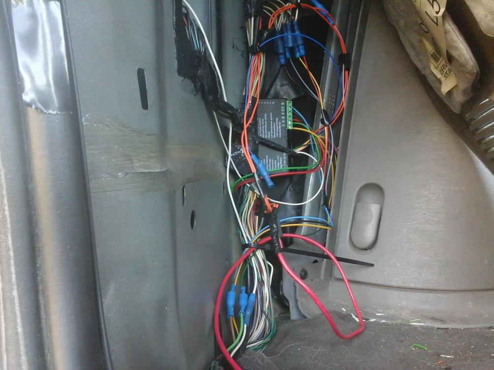

Managed to run Battery feed wire below carpet and sound deadening felt alongside original wires and exit it into engine compartment via rubber bung that is obviously the left hand drive steering wheel shaft hole.
Here's the resultant picture behind panel at back door.
