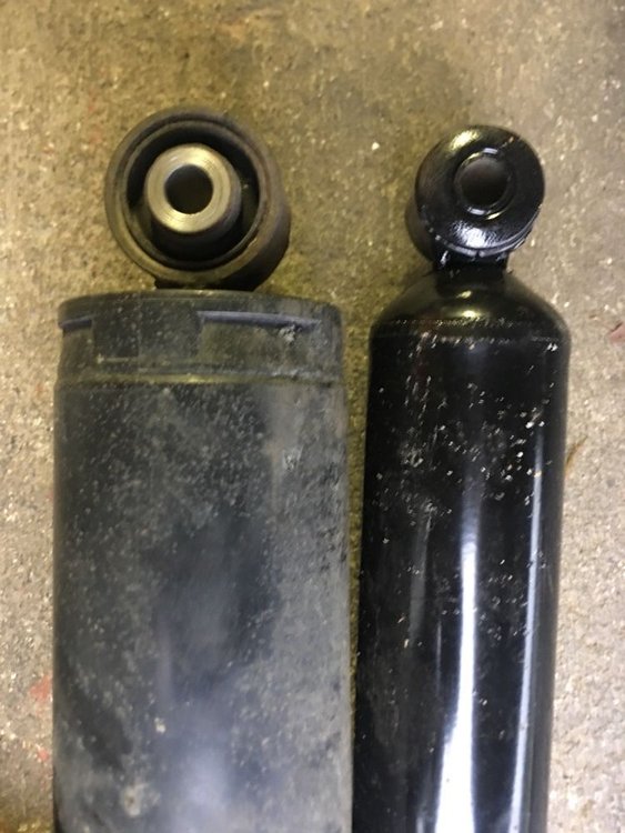

2005 T&C — I was doing my front shocks since they were definitely softening up, so I figured I should change the rears while I was at it, and Monroe was having a rebate anyway. Stupid me, I didn't actually look under my vehicle before ordering... New ones arrive and I go to replace them, then see that the rears are the super heavy duty ones, that I think are called "Nivomat". They are Sachs, and appear to be about $250 each online. The Monroes I got are wimpy and cheap compared to these, and the original stout ones seem to still be good, very stiff (in fact I can't compress by hand).
I installed the replacements because I figured I already had the parts and should just do it, now I am second guessing myself. So the question is: should I put the originals back in and try to return the new ones? I haven't tried loading the van up heavy with the new ones yet to see if I can notice a difference. Hoping to hear from others who have confronted this and what their thoughts are. Thanks!

I have an 04 with the nivomats, 183K miles and going strong with them! Put them back on, you will DEFINITELY notice a BIG difference at even a half load in the rear! To go cheaper replacements that can take any load, you with need a load leveler type shock(they have a coil spring mounted on them) Monroe makes them. It will be ALMOST as good as the nivomat's. There rear leaf springs are a little softer rating for nivomat equipped vans, hence regular rear shocks will allow more rear squatting when loaded.

Thanks for the reply rebel59, I think you are definitely right here... only rode on these for a couple days and while I didn't notice a difference in feel, I'm pretty sure the back end must have bottomed out on the bumper with these new shocks.
Here is a picture of the driver side rear bumper, taken a while ago, but I'm pretty sure it looked like this when I was under there swapping out the struts:
I just looked now and here is that same bumper (sorry, terrible picture but it's raining here and phone camera wasn't cooperating):
It has definitely made contact and gotten a beating. Putting the original struts back in!

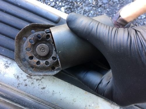

Jounce rebound rubbers. Comes with 8mm or 10mm threaded stud. Must be hand tightened on as bolt head is right down bottom and rubber to remove if socket required. I had to take my old ones off with Stilsons..See picture of In-process of removal..

goggs, yes I know what that is (M8 x 1mm thread, btw), I already tried to replace the other one, that didn't go so well... That other side bumper was already gone, as in, foam completely absent and only the mounting base was left attached to the van. I used a wheel bearing nut socket from another vehicle to get it off because it looked like the holes would coincidentally line up:
So that was great... until the bolt sheared off inside the frame!
Now what do I do? I've extracted bolts before, but at least in places where you have a straight line of access. Here the rear axle is in the way, so I can't get a drill on it. Any suggestions for how to extract that one would be appreciated (sorry for bad picture, my camera stabilizer has gone kaput).
