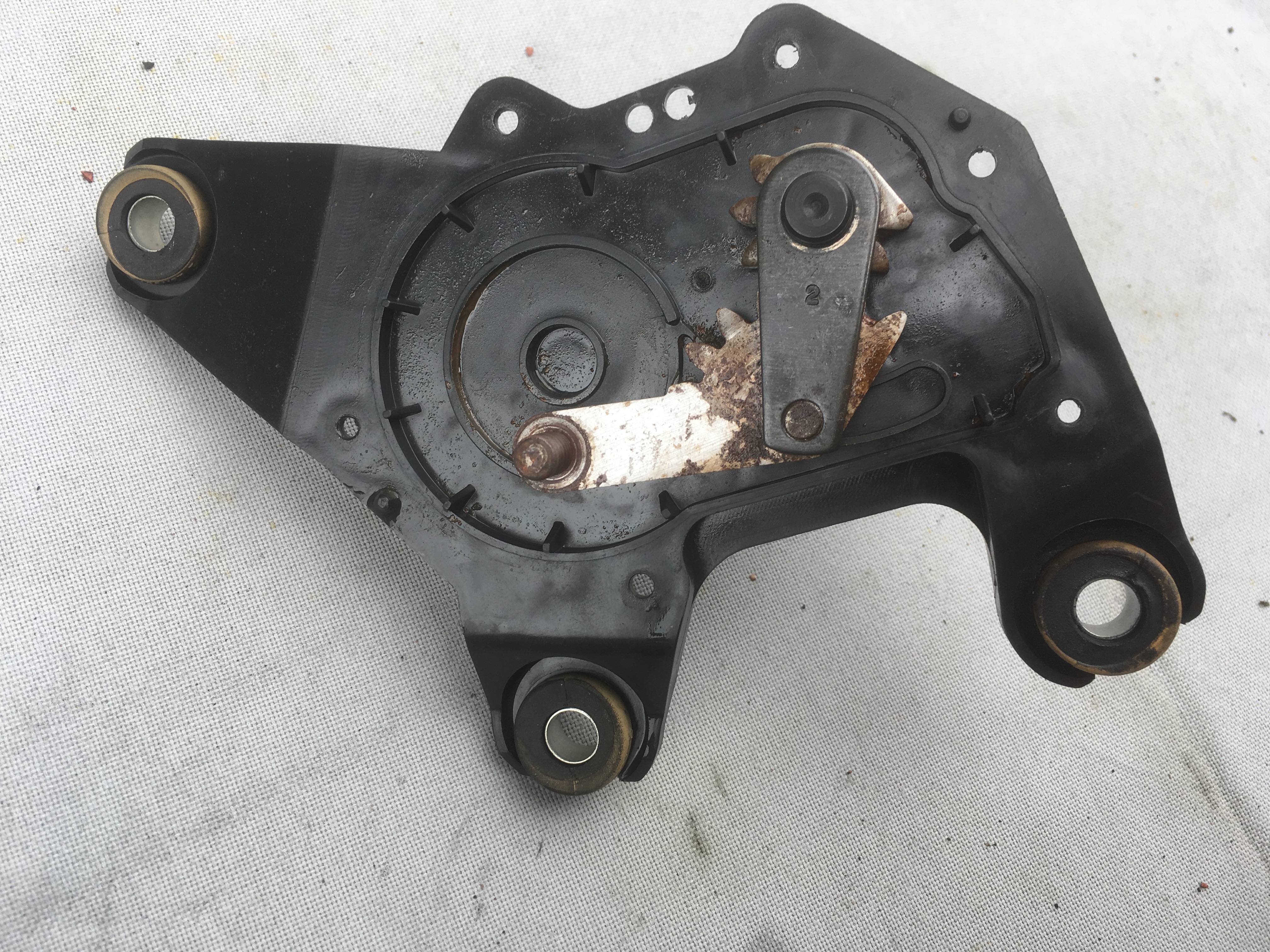

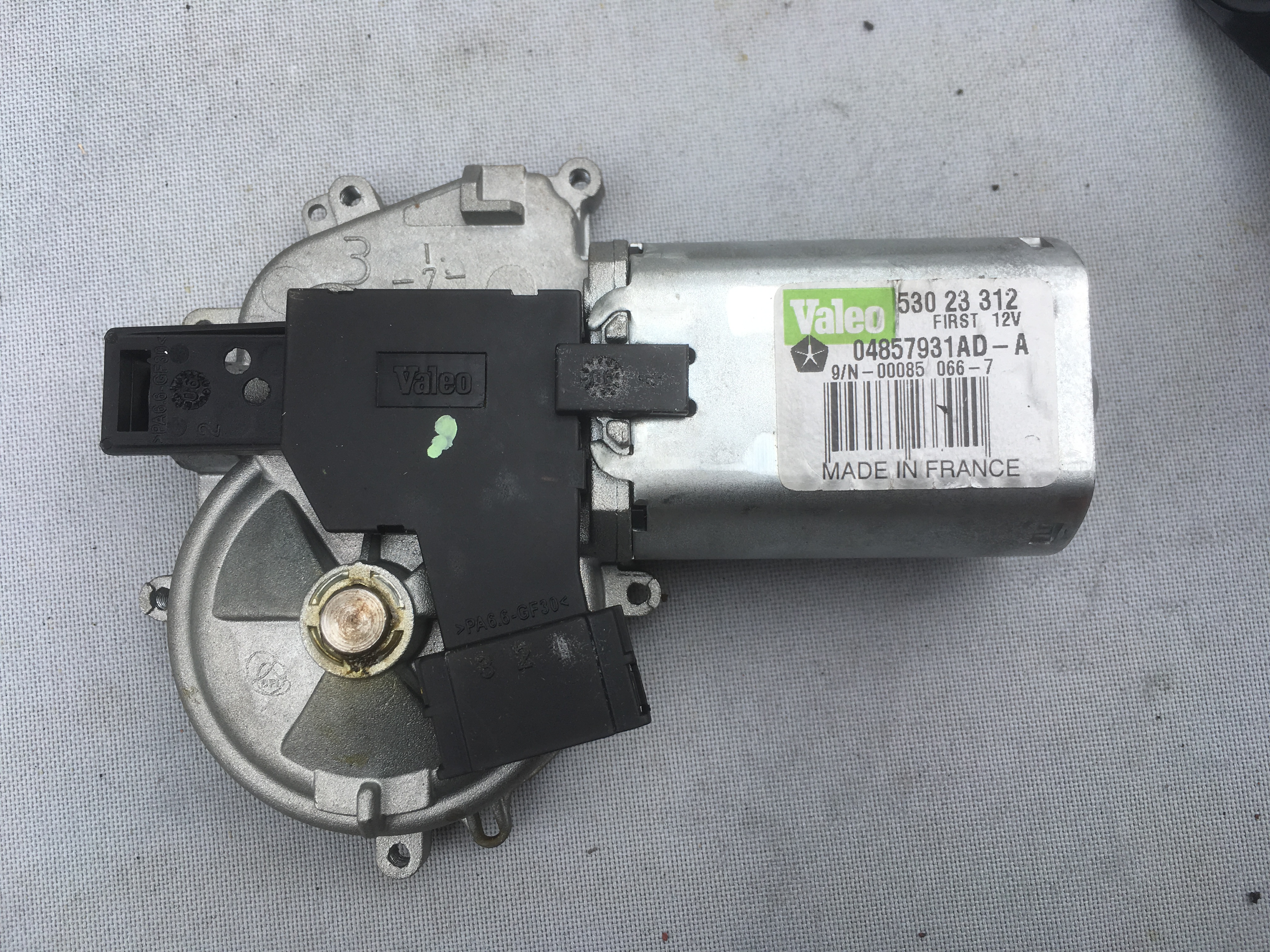

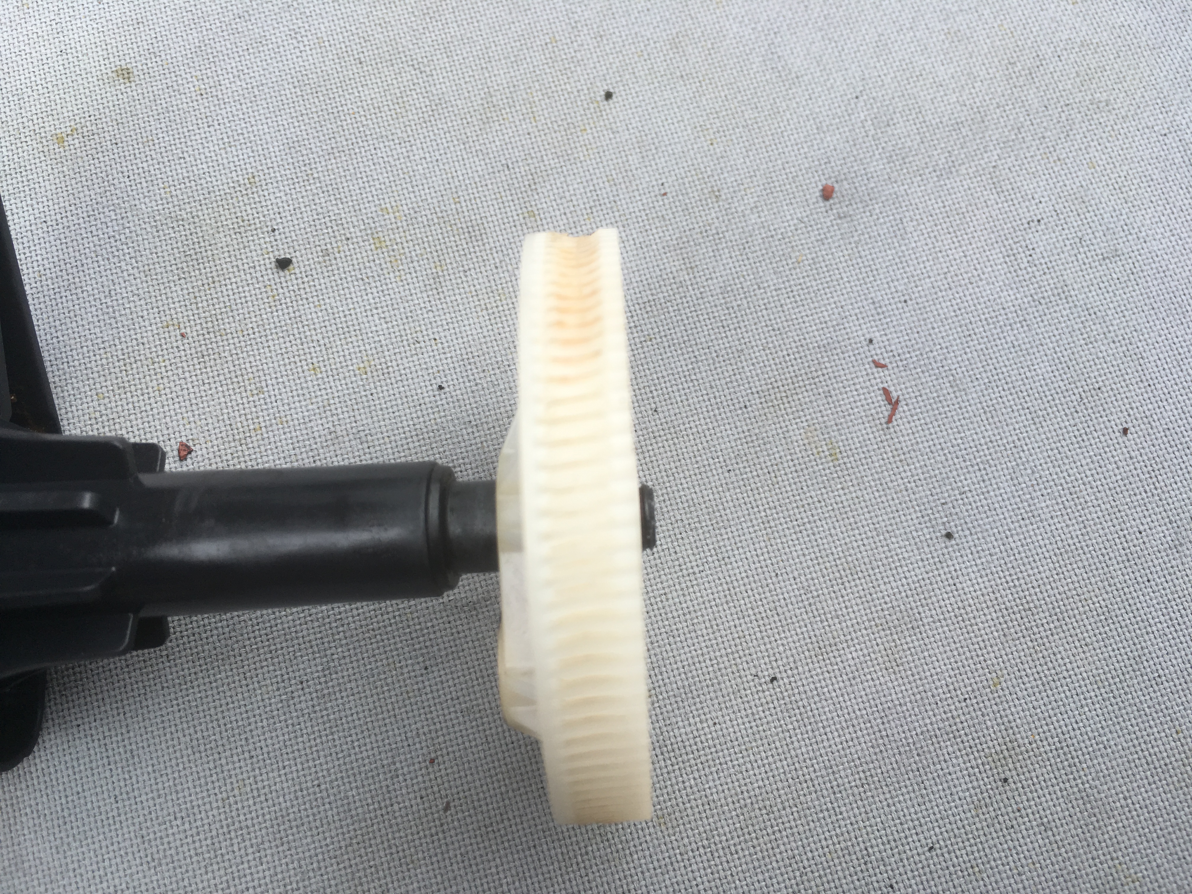

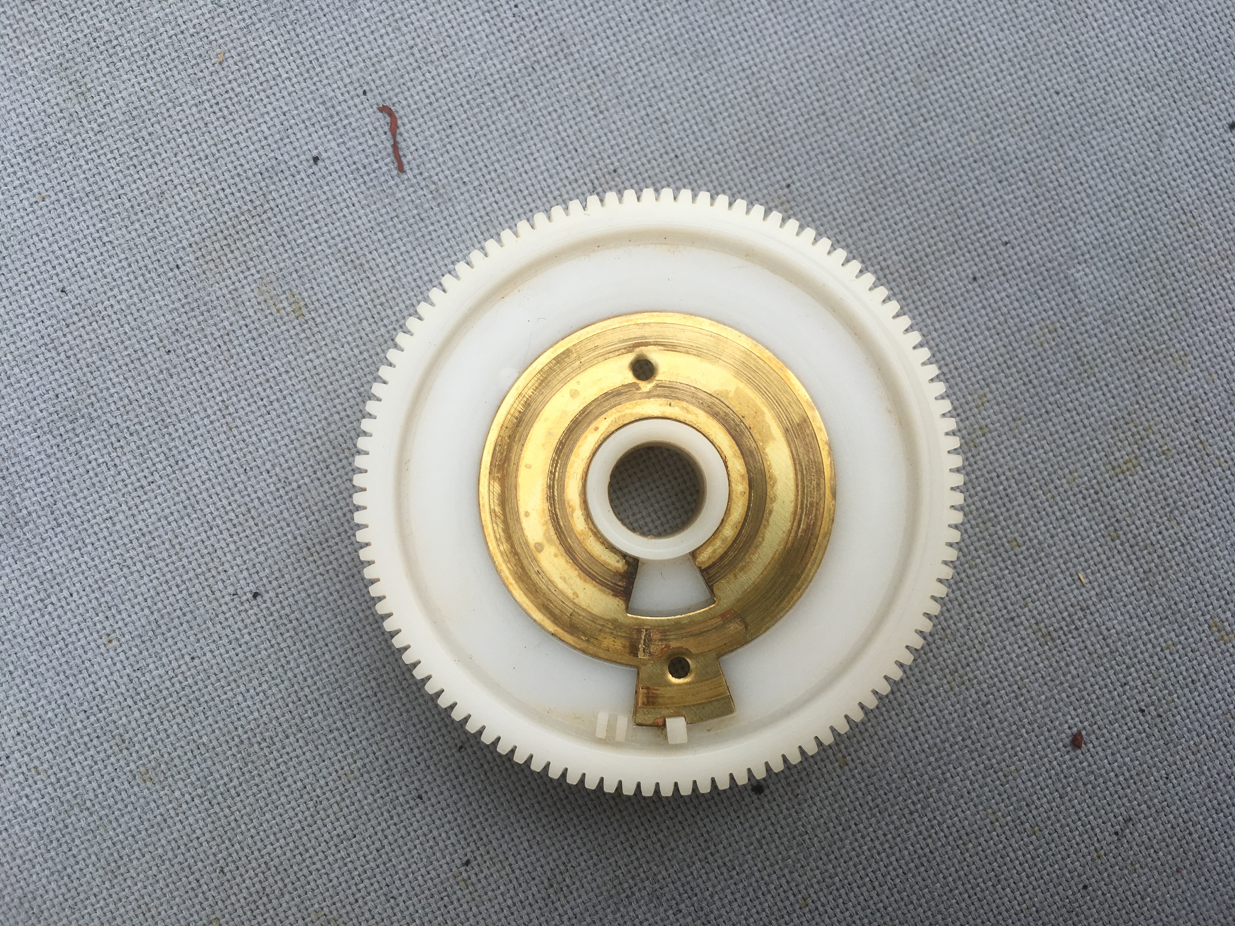

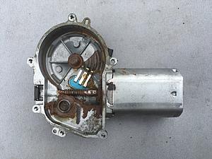

I finally got round to investigating my rear wiper problem more thoroughly. After dismantling the motor assembly I discovered that the main drive gear, which is made from nylon, is worn away in the area at the exact point where it reverses rotation. The assembly doesn't use limit switches, just a clever design of the steel gears to switch direction of the output shaft, and a break point in the electrical contact plate for the park position. See the attached photo's for a better understanding.
