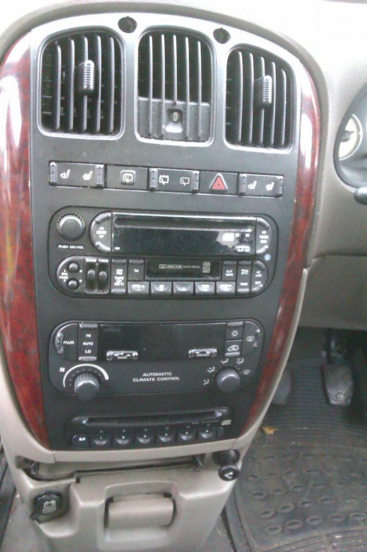

Hi Guys.
I have a u.k. 2004 voyager
I have been having trouble of late with the battery going flat, the problem is that I don't use the car very often.
I have purchased a solar powered battery maintainer which sits on the dashboard and puts a trickle charge into the battery via the cigarette lighter socket.
The query I've got is deciding which socket to put the plug into as it needs to be live without the keys being in the ignition.
Can anyone give me some information.
Thanks in anticipation.

I've a 2003 Voyager and the accessory socket with the black snap off cap, at base of centre console, left side (uk passenger side), is live all time. See picture, bottom left hand, black cap.
