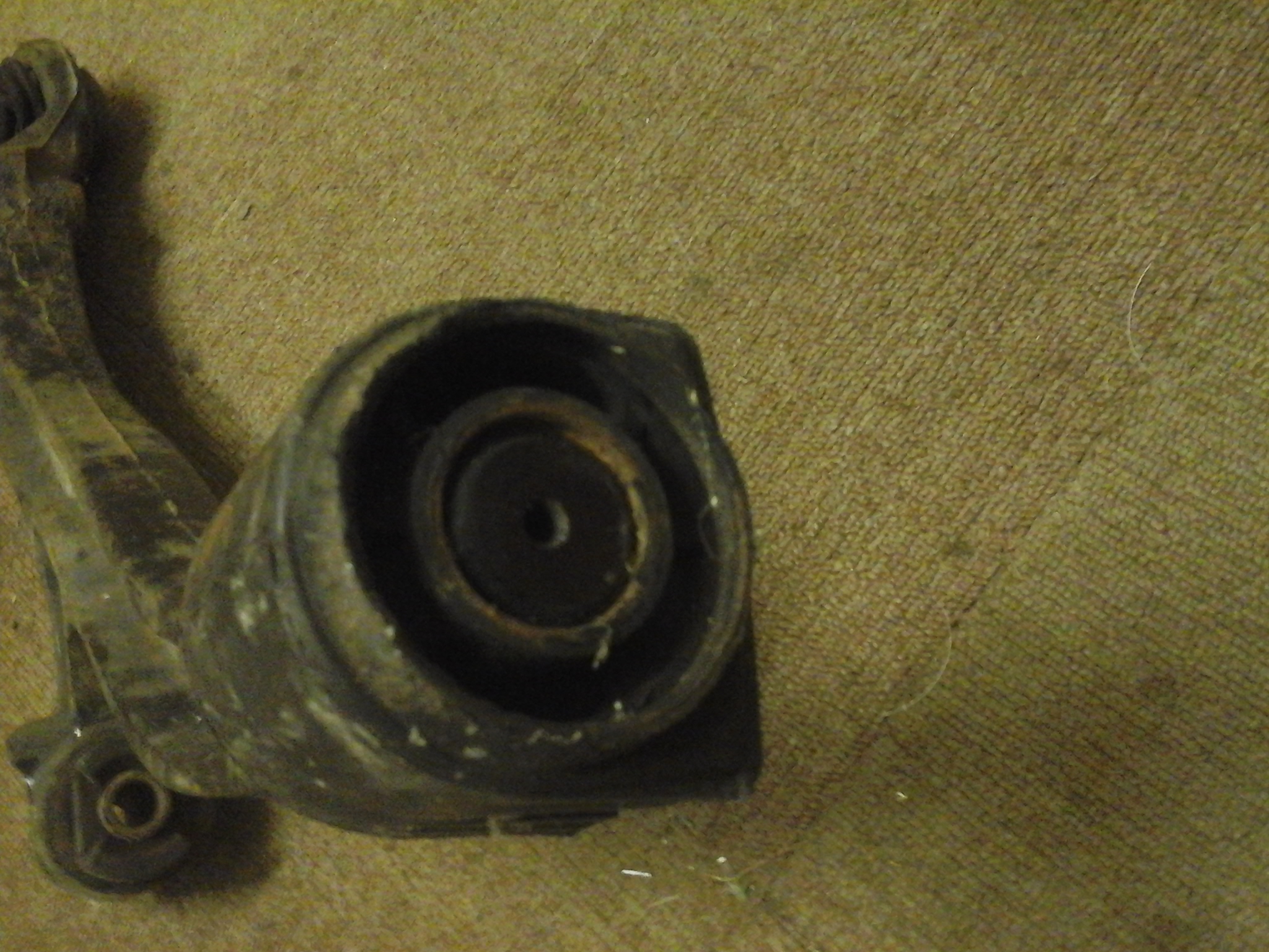

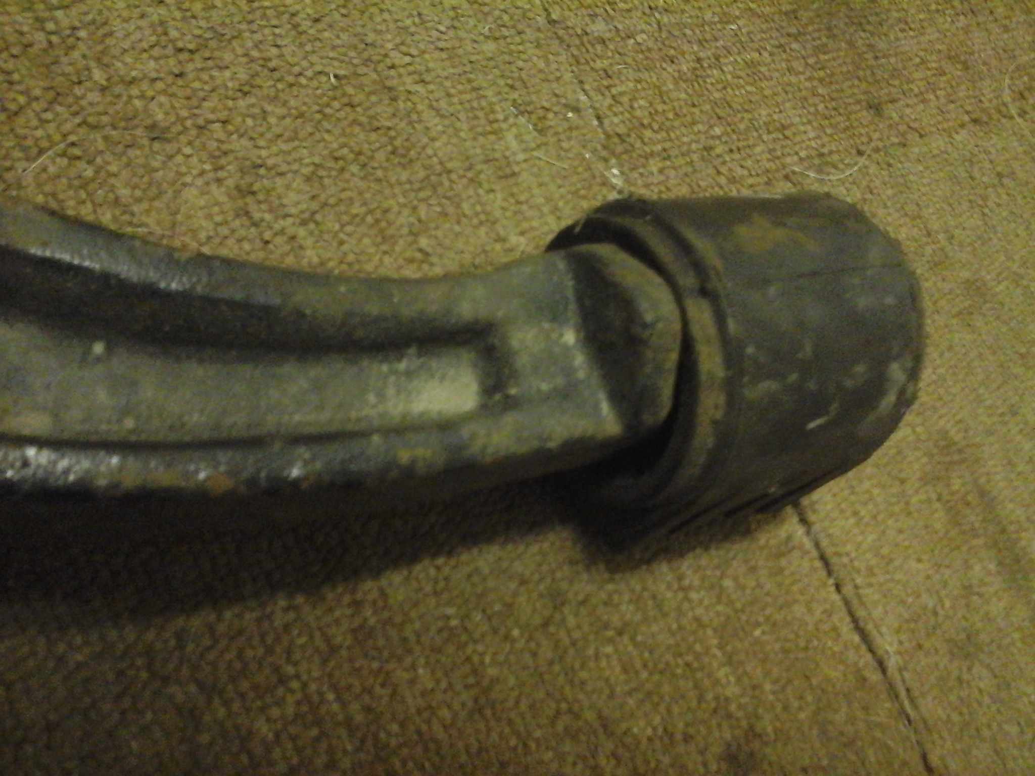

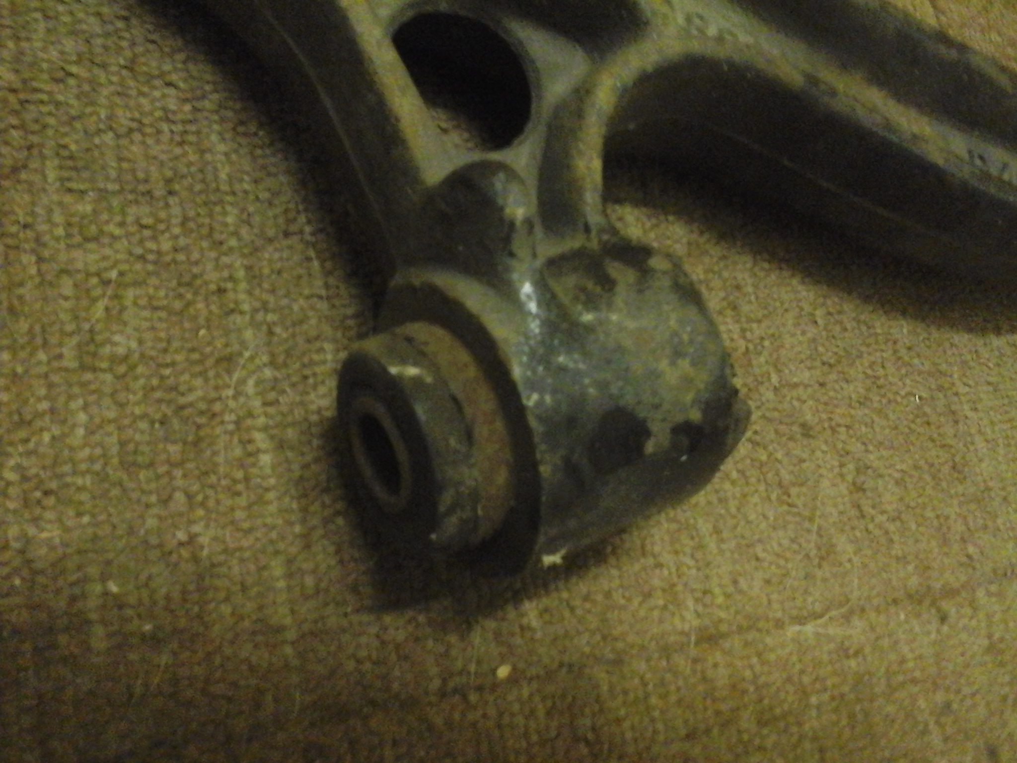

Your car is same as mine including the age. Here's pictures of the control arm that was fitted on my car..

Per Euro they look like 6158 30090 & 6158 30100. Or how about Fleebay the 2 off for £59.99. Last pair. Run. Same ribs on back rubbers too. ATP producer.

Thanks for posting those photos. I was able to see them before I logged in, but I think I have the same type of btm arms. I think the kit I bought doesn't actually fit all Voyagers from 00 - 07 after all. Have now found the type of arm I need, judging by the photos. Will update this thread after I get the things fitted.
