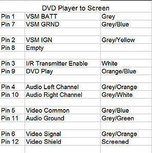

That's because it's a CD player, not a DVD player. The SatNav discs are CD, not DVD.
So I guess that I am looking at hooking up rear roof screen to the optional 6 CD changer
Is this the original fitment screen or an aftermarket. If it's the original then it's not worth spending time or money on.
These are the pin-outs at the back of the DVD mulit-changer unit.

Thank You for the reply with the pinout chart! Yes this is O.E. equipment, and probably from the push MOPAR made at the time(04) to boost lagging sales, to have the rear entertainment STANDARD here in the USA. The "gist" is I have the pieces and they work, it is just that I don't want to use the separately mounted player unit if the changer(says plays DVD's) can do that function. TIME to play with it ..I HAVE..NO $$ involved other than finding a connector if needed.
In my eyes...an easy swap IF the 6CD changer would work as the player unit.
Thanks again for the reply!
